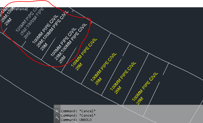

LispLearner Posted February 14, 2023 Author Share Posted February 14, 2023 Hi @devitg @tombu while running this code in sample2.dwg, i m facing following issue... MTEXT in BOLD condition are getting changed properly but MTEXT is getting duplicated which is already in UNBOLD condition, please check the below screenshot, also attaching sample file. SAMPLE2.dwg Quote Link to comment Share on other sites More sharing options...

devitg Posted February 14, 2023 Share Posted February 14, 2023 1 hour ago, LispLearner said: Hi @devitg @tombu while running this code in sample2.dwg, i m facing following issue... MTEXT in BOLD condition are getting changed properly but MTEXT is getting duplicated which is already in UNBOLD condition, please check the below screenshot, also attaching sample file. SAMPLE2.dwg 57.28 kB · 1 download I did to suit your sample, I will add some feature so to not unbold the unbolded text. 1 Quote Link to comment Share on other sites More sharing options...
devitg Posted February 14, 2023 Share Posted February 14, 2023 2 hours ago, LispLearner said: Hi @devitg @tombu while running this code in sample2.dwg, i m facing following issue... MTEXT in BOLD condition are getting changed properly but MTEXT is getting duplicated which is already in UNBOLD condition, please check the below screenshot, also attaching sample file. SAMPLE2.dwg 57.28 kB · 1 download Find attached lisp file unbold-02.lsp Quote Link to comment Share on other sites More sharing options...
LispLearner Posted February 14, 2023 Author Share Posted February 14, 2023 (edited) hi @devitg sorry for troubling you again, its might be again my mistake, i missed to explain you properly.. here I tested with you recent code in SAMPLE2.dwg, its considering only yellow coloured BOLD Text & making it UNBOLD. actually it should not consider colour (just for the showing difference of BOLD Text, i changed it to Yellow on sample2.dwg) another issue is if we run the command for the second time on the same dwg, it again starts to duplicate text as shown in previous screenshot. attaching another sample3.dwg...... kindly check it. SAMPLE3.dwg Edited February 14, 2023 by LispLearner attachment missed Quote Link to comment Share on other sites More sharing options...
