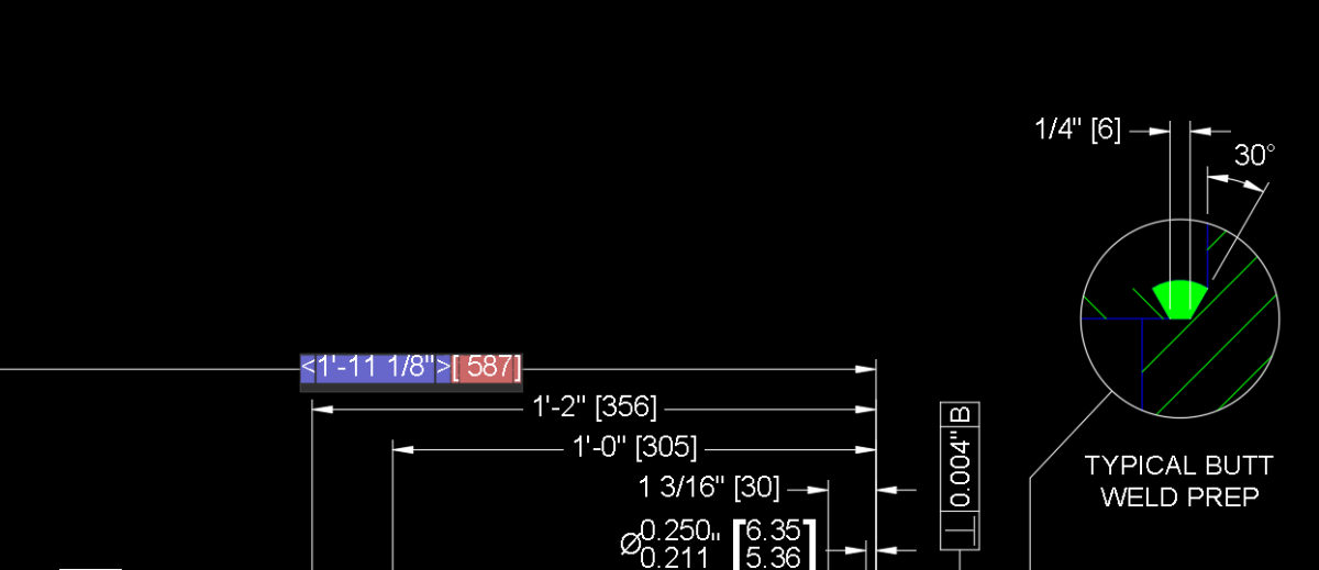

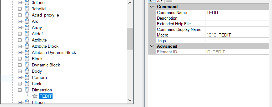

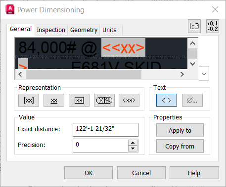

ColinPearson Posted February 10, 2023 Share Posted February 10, 2023 Hey folks! This has been an issue for the last 2 years for me running ACAD Mechanical 2019/20/21/23 at my new job. When I double click to edit a dimension, this Power Dimensioning dialog box shows up and it's terrible. I want the 'normal' text editing box to come up like if you were to TEDIT the Dimension. I thought I had the Double-Click Action for Dimensions set to TEDIT, but it doesn't seem to stick. Any idea how to turn off this Power Dimensioning? Thank you!! Quote Link to comment Share on other sites More sharing options...

ColinPearson Posted February 14, 2023 Author Share Posted February 14, 2023 Hi @BIGAL Thanks for the reply. Sometimes I use DDEDIT, but what I really want is just the plain double click to initiate either TEDIT or DDEDIT on a dimension. You have any idea how to set that up? Thank you! Quote Link to comment Share on other sites More sharing options...

SLW210 Posted February 15, 2023 Share Posted February 15, 2023 Try AMPOWERDIMEDITOR = 1 Quote Link to comment Share on other sites More sharing options...
ColinPearson Posted February 15, 2023 Author Share Posted February 15, 2023 That actually is what AMPOWERDIMEDITOR is set to currently. I wonder if I can exports a Workspace from Mechanical to invoke in Vanilla? If I got to the Vanilla Profile in Options>Profiles, then try to load a different workspace, the one I was using in Mechanical does not load, ACAD says it does not exist. Quote Link to comment Share on other sites More sharing options...

ColinPearson Posted February 16, 2023 Author Share Posted February 16, 2023 @BIGAL thank you for your continued conversation, I think I may have it figured. @SLW210 That LISP works, at least for now until our IT updates something LOL. But, no I don't use the ribbon but the LISP you linked to is working. THANKS! I would like to know how to use a Workspace from Mech in Vanilla if that's something you might be able to shed light on though. When I open Vaniklla then invoke Workspace and type in the name of my saved WS that I always use in Mech, Vanilla tells me that there isn't a WS called that. Maybe that's a dumb sounding question, but how could I transfer/export/use a WS from Mech in Vanilla? The WS was actually created in Vanilla years ago (different employer, many releases ago) and I've just been tweaking it ever since. Quote Link to comment Share on other sites More sharing options...
