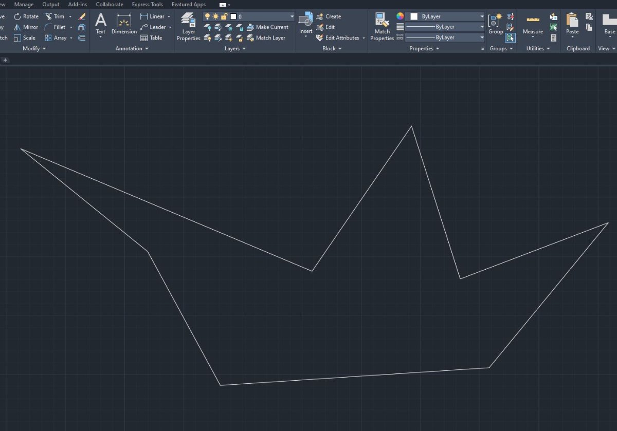

Find gaps in polygon
I don't mean to sound like I'm talking down to you - not my intent AT ALL - but can I ask why not just select the polyline and look for two grip that are close together?  I'm sure there's more than one reason this may not be an ideal solution (multiple/many gaps and you want something to handlethem all at once, gaps so small that it's had to discern the multiple endpoint grips, etc)... just asking
Thanks Colin,  I  am a newbie and will take any and all advice. Usually the gaps I have are very tiny, and cannot see grips that are close together.  I   have to take every point where two segments meet, and zoom right down into that intersection. All very time consuming and tedious, and it doesn't always show the gap if the gap is so small.. there is always one more zoom needed :)
Hence my question, surely there must be a better way ;)

I'm guessing there probably is a way.  On the other hand, what leads to the gaps?  Are you drawing just by trying to place the end of a new PLINE at the end of another one "by eye"?  Are you using the Snaps so that the next PLINE you draw is geometrically starting from teh exact endpoint of the previous PLINE?

I would run the join command to make it a polyline. then this will add a circle to current layer at the start point of any open polyline selected.

The best way to fix a gap is not to draw it in the first place. Is it possible to draw a polyline to represent your polygon? That way the nodes are guaranteed to close, especially if you use the Close option to finish it.

If it was me, and it is an occasional occurrence - sometimes happens - I'd break at a point then selecting either side of the break will select the part up to the gap, then you can fix the gap, join it all together. However it is only an occasional thing for me so I have never needed to do any more than that (most often if (ahem) "Someone else" draws a polyline to be hatched with a gap - but my drawings don't have a lot of hatching)
Good thinking, thanks Steve, this approach makes sense.The only problem I see ( for me)  is joining them all up again where I  broke the lines :)

That method of breaking the loop worked beautifully. Found the break immediately. Strange, because I  was able to fill the polygon with HATCH, which to me indicated that there was no  break!
Many thanks Steven P

'Join' comment or pedit (polyline edit) and use the option join (depends which version of CAD you are using when the join command was added)
