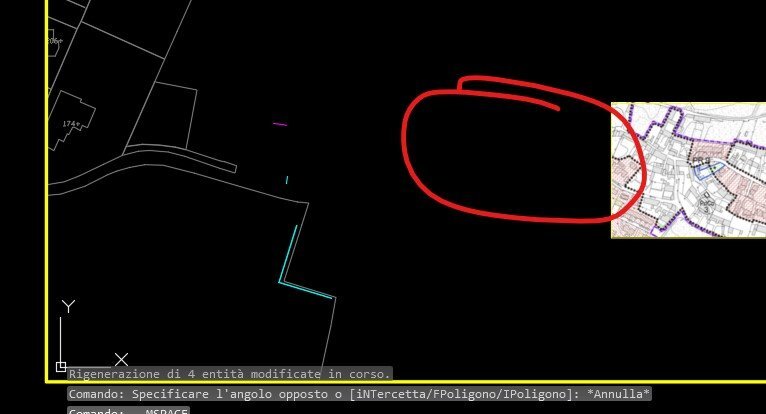

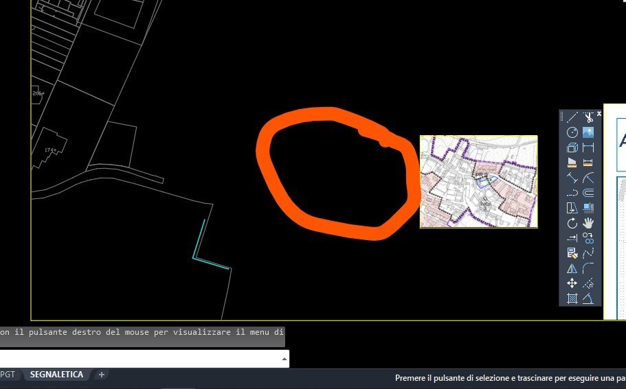

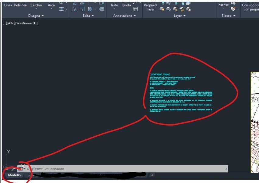

Giovannino60 Posted February 8, 2023 Share Posted February 8, 2023 I inserted a text copied from another file, in model space, then I went the loyout but you can't see, I checked even if the layer was frozen instead no, I tried to change layer but you can't see, what can I do? Thank you Quote Link to comment Share on other sites More sharing options...

Giovannino60 Posted February 8, 2023 Author Share Posted February 8, 2023 If you mean that the scale of the box is too small, it's not like that, I am attaching the screen shots. If you look at the white image do you see that near the same proportion, the writings are not visible? Quote Link to comment Share on other sites More sharing options...

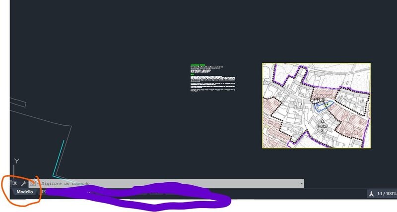

Steven P Posted February 11, 2023 Share Posted February 11, 2023 Copy the text to notepad and then copy and paste from there to the drawing - removes pretty much everything if you are stuck - and then you can copy format from a text you like to get the formatting right Quote Link to comment Share on other sites More sharing options...
Giovannino60 Posted February 12, 2023 Author Share Posted February 12, 2023 Yes, I did as you told me and now I see the text. Thank you Quote Link to comment Share on other sites More sharing options...
