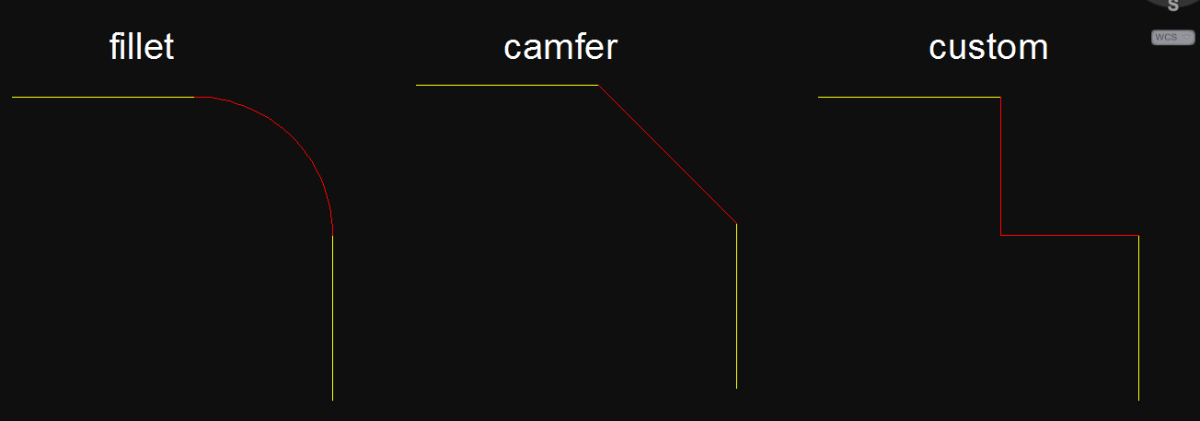

A MODIFIED CHAMFER FOR CUSTOM USE
tefached2809
thank you all for your help! i got all your lisp and will use it depending on what the drawing is presented to me, polyline or line.
it's really close to what i wanted and can work as intended.
and i am already happy with what you guys gave me.
PS: but for expert LISP writers out there here's the more detailed explanation on how i wanted the command
SUMMARY: A custom command just like chamfer or fillet that does a "notch" instead of an arc (for fillet) or a diagonal (for chamfer)
Details:
  1. can work on lines or polylines
  2. case 1 if objects is short to the intersection it extends it up to the notch
  3. case 2 if objects is longer than the intersection it trims it up to the notch
  4. case 3 if lines meet at intersection it creates the notch
  5. case 4 if objects are lines everything are created as lines (just like chamfer would do)
  6. case 5 if one object is polyline it joins objects into the polyline (just like chamfer would do)
  7. case 6 in case 0 distance is used it will extend or trim the line to meet at intersection (just like fillet and chamfer)
Procedure:
  1. type in command
  2. type in distance / use previous distance (distance is recorded in case of multiple uses (just like chamfer do)
  3. pick object 1
  4. pick object 2
end.

sweet! this one is way better! thanks a lot for this. it's almost perfect! great job steven!
Only got to apologise for posting loads of posts on this thread.... It is nearly where I am happy with it and I'll maybe have another go to make it so.

On 2/8/2023 at 6:17 AM, tefached2809 said:
hi thanks for this, it worked really well however is there a possibility to do it without me picking the corner? just how chamfer works if the lines do not intersect on the corner yet it extends the line up to the notch,
but regardless, i already appreciate your help.

1 hour ago, Steven P said:
Edited the code above with Devtigs suggestion. Am happy with this now... mostly....
(apart from a "select line or enter [D]istance" type of thing but that can be another day)
wow! man you have done it! it is perfect! thank you so much, slow claps to you sir!
