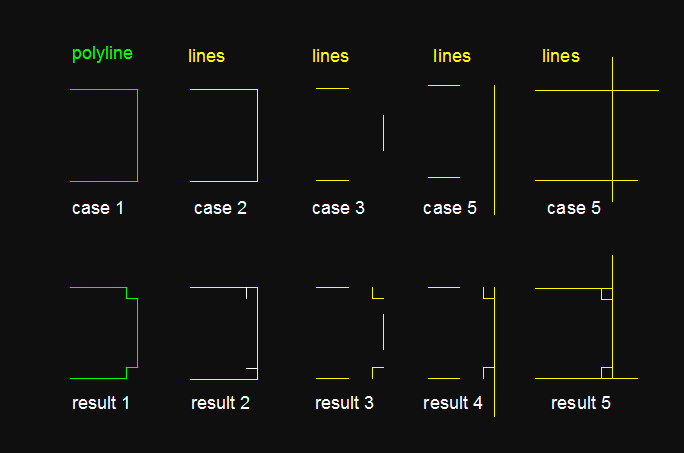

hi can anyone help me make an autolisp command that makes a perpendicular line based on distance given instead of a diagonal line as shown in attached image spacer.png
Are your original lines lines or polylines, or both? And do you have any sizes or the cut out, or like the regular chamfer do you want the user to enter a size as required?
(if it is just lines it is easier to do than polylines, but someone might have something that does this all ready)
hi, yes i want it to work on lines or poly lines just like how chamfer works, and i need to input the distance too, just like how chamfer works, but if it  is easier on just lines i'll take that too.
Works for lines I think.
-EDITED FROM HERE-
This appears to work for Polylines - I haven't tested it fully and no error catching such as polyline segments shorter than the chamfer distance, or a full range of line angles. Could be made to work more like a regular chamfer, and perhaps could be called notchchamer as a LISP name, test wi;l do for now....
Should be able to be modified later to do lines and polylines

17 hours ago, devitg said:
Please test it for lines
hi thanks for this, it worked really well however is there a possibility to do it without me picking the corner? just how chamfer works if the lines do not intersect on the corner yet it extends the line up to the notch,
but regardless, i already appreciate your help.
16 hours ago, Steven P said:

thank you i tested this too and it worked up to the point that it makes the notch but somehow i got error on "breakatpoint" unknown command
and if working on polyline is hard, even if just lines it is ok for me
10 hours ago, marko_ribar said:
Here is my attempt :

this is really nice!
your version is the one closest to what i have in mind i did some tests and it is perfect on polylines however some cases i have lines as shown in the picture can you please consider it to be able to do them too just like how chamfer command works
See attached
notch-lines-as-chamfer -do.LSP
Thanks.
Devitg has a solution there for lines but I might have a look - I reckon I can change my version around to do both - that work stuff is getting in the way today!!
(the pictures you show are the LISP working it out but hasn't quite been told what to do with lines)
Edited by Steven P
14 minutes ago, Steven P said:
Thanks.
that would be really great if it works on both,
oh sorry, i am bad in english so i try to show it visually, so i want it to work same as how chamfer would do it, for polylines or lines, so in some cases the lines are not yet meeting on corner the command extends it up to the notch, or in some cases the lines are already crossing on the corner so the command will trim the excess lines.
 your version works really well if the project is already on polyline.
See attached
Please show us some real and true sample.dwg .
I suppose this notch are cut to bend the metal or whatever material to become a 4 sided PAN from a Flat sheet .
If it is so the polylines will be closed.
But maybe despite it is closed, the notch could be at some , and not all corners .
  • Thanks 1
here's an example, in some cases it's drawn in polyline, and sometimes only lines (and poorly drawn with gaps and extended lines) but the result is just the same be it closed or not. but it is still nice to have it work on polylines as well, anyway your LISP is great and i am using it now, i just need to explode the polyline to make it work.
SAMPLE.dwg
I made something that I quite like.  It works on your dwg example. It could use some work to make it more versatile.
- The code works only for polylines.
- Only for horizontal/vertical lines.
- There's hardly any error check.  Use it as intended, or I don't know what will happen.
Command CCF
- user sets a distace dist1
- user selects the polyline
- Now pick corner points p1.  don't pick the end of the polyline.  It only expects corner points (best put on OSNAP)
- p1 now gets replaced by p2 p4 p3
