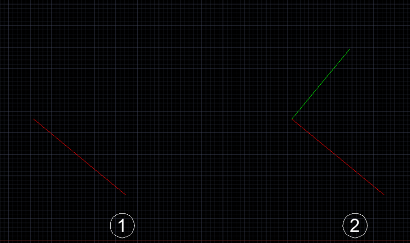

hello all:
i am using this routine...
to draw a line perpendicular to an element
the problem is that I would like it to be perpendicular to a point
1.- that is, select the element
2.-  select a starting point permanent
3.- select final point

This doesn't make any sense maybe a example drawing?
this routine does what i need but it doesn't show the line while i select point two...
I think the command grdraw is required

I liked this routine ,
but I need that, in addition to selecting an element, it asks me for a point in that element
For example, if I want to make the line perpendicular to the end of that line

DEAR TSUKY :
it is exactly what i needed
but...
You could add something so that when the command is interrupted, the variables such as the cursor position and the osnap they return to their initial position.
thanks
leonucadomi
I edited the previous post to insert an *error* function, this resolves if the command is interrupted.
  • Thanks 1

This?
(defun elperr (ch)
  (cond
    ((eq ch "Function cancelled") nil)
    ((eq ch "quit / exit abort") nil)
    ((eq ch "console break") nil)
    (T (princ ch))
  (setvar "cmdecho" 1)
  (setvar "osmode" old_osmd)
  (setvar "orthomode" old_orth)
  (setvar "snapang" old_snp)
  (setq *error* olderr)
(defun c:elp ( / olderr js ent-sel ent pt_sel obj_curv old_osmd old_snp old_orth param deriv pt_tmp p_from p_to)
  (vl-load-com)
  (setq olderr *error* *error* elperr)
  (princ "\nRaise a perpendicular to: ")
  (while (not (setq js (ssget "_+.:E:S" '((0 . "*LINE,ARC,CIRCLE,ELLIPSE,RAY"))))))
  (setq
    ent-sel (ssnamex js 0)
    ent (cadar ent-sel)
    pt_sel (cadar (cdddar ent-sel))
    obj_curv (vlax-ename->vla-object ent)
  (cond
    ((member
      (vlax-get-property obj_curv 'ObjectName)
      '("AcDbPolyline" "AcDb2dPolyline" "AcDbLine" "AcDbArc" "AcDbCircle" "AcDbEllipse" "AcDbSpline" "AcDbRay" "AcDbXline")
      (setq
        old_osmd (getvar "osmode")
        old_snp (getvar "snapang")
        old_orth (getvar "orthomode")
        pt_sel (vlax-curve-getClosestPointTo obj_curv pt_sel)
        param (vlax-curve-getparamatpoint obj_curv pt_sel)
        deriv (vlax-curve-getfirstderiv obj_curv param)
      (setq pt_tmp (polar pt_sel (+ (atan (cadr deriv) (car deriv)) (/ pi 2)) 100.0))
      (setvar "snapang" (angle (trans pt_sel 0 1) (trans pt_tmp 0 1)))
      (setvar "orthomode" 1)
      (if (null (setq p_from (getpoint "\nFrom point <lastpoint>: ")))
        (setq p_from (trans pt_sel 0 1))
      (setvar "osmode" 0)
      (initget 9)
      (setq p_to (getpoint p_from "\nTo point : "))
      (command "_.line" p_from p_to "")
    (T (princ "\nInvalid object!"))
I'm having a bit trouble getting this useful lips working in bricscad.
Initially it would error in this bit:
changing it to this seems to work (i think)
pt_sel (cdr (cdr (cdr (car ent-sel))))
Bur now it fails on this bit:
Command: LPER
Select entities:
; ----- LISP : Call Stack -----
; [0]...C:LPER <<--
; ----- Error around expression -----
; (VLAX-CURVE-GETCLOSESTPOINTTO OBJ_CURV PT_SEL)
; in file :
; D:\360G\Support\Lsp\LPER.lsp
;bad argument type <(-1)> ; expected <LIST> at [vlax-curve-getclosestpointto]
any ideas why?
Thanks
P
LPER.lsp
Change it to this :
(setq
  ent-sel (ssnamex js)
  ent (cadar ent-sel)
  pt_sel (osnap (getvar (quote lastpoint)) "_nea")
