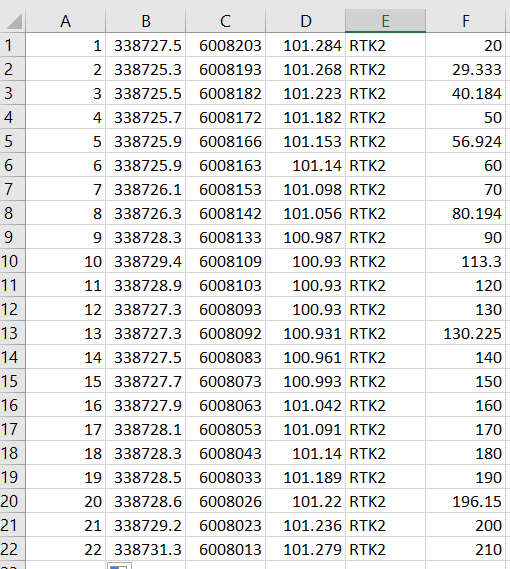

Ok so you want to do setout, basically you need a csv file of points, the simplest is exactly that use POINT set PDMODE to 34 add all the points you want, data extraction should allow you to select all points and make a csv file AND go to excel, in excel add a column and give all rows a pt number you can say make control 1000 1001 etc the rest 1+, save as a csv file, you can then load into your Leica as a job and do setout.
Further down the track can look at better ways of making points files.
There are ways of say taking a setout based on 1 co-ord system say control point is at 1000,1000 and setting up on a control point at 334567,23456 so long as you have a backsite to another point to get correct orientation.
Our surveyors would do a survey say at 1000,1000 but move it and rotate to true world control then give it to us. yes they had GPS for control.
