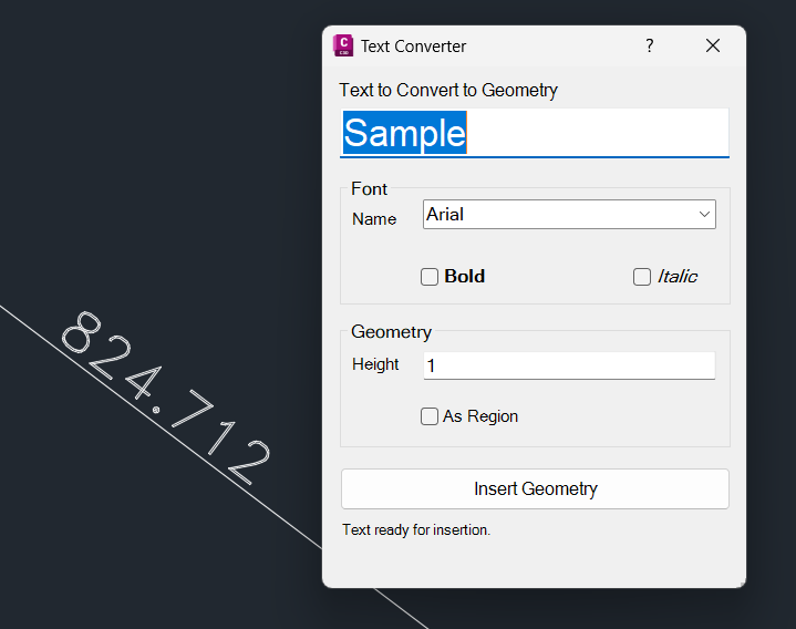

BIGAL Posted February 6, 2023 Posted February 6, 2023 (edited) tombu trying to find latest version. I have something. Text 2 geom.zip Edited February 6, 2023 by BIGAL Quote
thetechgeekko Posted October 3, 2024 Posted October 3, 2024 (edited) On 2/5/2023 at 10:40 PM, BIGAL said: tombu trying to find latest version. I have something. Text 2 geom.zip 99.75 kB · 20 downloads How to use this , I selected the text and run the command but it shows this. Edited October 3, 2024 by thetechgeekko Quote
