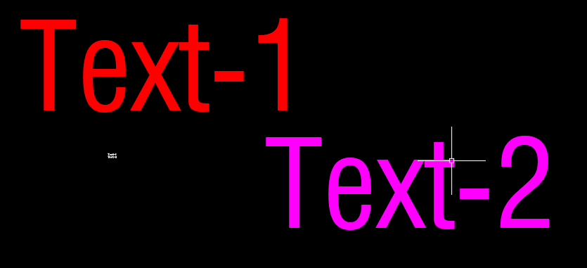

Can anyone help me on this code I wrote. The purpose of the code is to combine two text entities combining as a MText deleting the selected and placing in desired location. When I run the above code it does not work
The code runs with the following Error:
Select first text entity: Select second text entity: Select location for combined text: nil
Please help, thank you
I have a library of entmake routines, so I don't need to copy and paste them every time I want one. get it working once and it will work every time after.
Using that instead of your code gives me the below: Try that. Also added a couple of princ to report what the user clicks
Problem with your code I think you need the cons 100s:  (cons 100 "AcDbEntity")(cons 100 "AcDbMText")

Thank you for the code, How do I retain the original text formatting for example color, height, font etc. of selected text.
if they are just text they don't have any formatting. you would have to pull other info like stevenp says. Tricky part is when calculating the text height.
You have to look at all text first to see their sizes. if they are different in anyway you then have to inject some math into the mtext string.
Using the smallest textsize as the "Base" (cons 40 h)
TextString = "\\C5;\\fConsola.ttf|b1|i0|c0|p0;test\\P\\H2x;\\C1;bigtest"
bigtest is 2x time bigger the orginal test text
