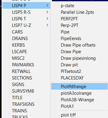

BIGAL Posted February 2, 2023 Share Posted February 2, 2023 Ok first thing my preference is for using layouts not all in model space, so most of my code is written around that method. The menu does as hinted above looks at title block in each layout and sets correct values. For pdf can do plot a range of layouts handy when you update say 1 or 2 sheets. Last question do you know how to make a menu, that is a custom mnu say using notepad, as per image can have lots of stuff in a menu. 1 Quote Link to comment Share on other sites More sharing options...
pegasus Posted February 3, 2023 Author Share Posted February 3, 2023 All the pages I want to make pdf are in the model, but there are also layouts. My goal is to make a pdf of the pages I want, in the sizes I want, and with the features I want, by making a selection. (also by selecting and advancing when I start the command) I'm not very advanced in making menu, but I know what I can change when I look at it. I hope I was able to explain. Thanks for your return. 8 hours ago, BIGAL said: Ok first thing my preference is for using layouts not all in model space, so most of my code is written around that method. The menu does as hinted above looks at title block in each layout and sets correct values. For pdf can do plot a range of layouts handy when you update say 1 or 2 sheets. Last question do you know how to make a menu, that is a custom mnu say using notepad, as per image can have lots of stuff in a menu. Quote Link to comment Share on other sites More sharing options...

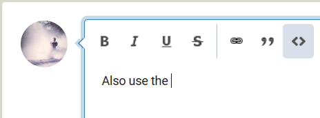

BIGAL Posted March 6, 2023 Share Posted March 6, 2023 (edited) Also use the <> option for your code. Edited March 6, 2023 by BIGAL Quote Link to comment Share on other sites More sharing options...
