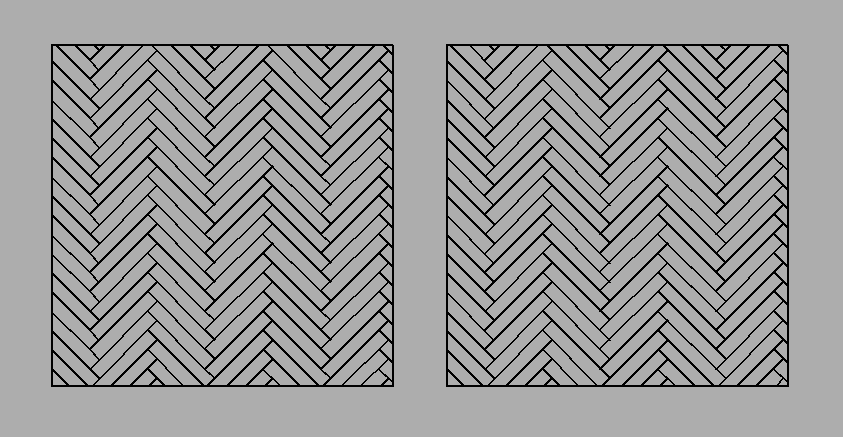

I thought to post two herringbone hatches which show that herringbone patterns can be formed from any sized tile and do not have to be limited to simple proportioned dimensions. Tiles with grout spaces are more difficult and I have limited myself to single lines only.
The pictures were drawn with a rotation of 45° because it is easier to calculate herringbone hatches orthogonally. I have calculated these patterns manually, but I suppose there are other quicker methods available!
*Hb221x65, Herringbone with tile 221x65
0,0,0,1313,-13,286,-1924
90,65,0,1313,13,286,-1924
*eldon January 2023
*Hb221x71, Herringbone with tile 221x71
0,0,0,3977,-1,292,-31090
90,71,0,3977,1,292,-31090
*eldon January 2023

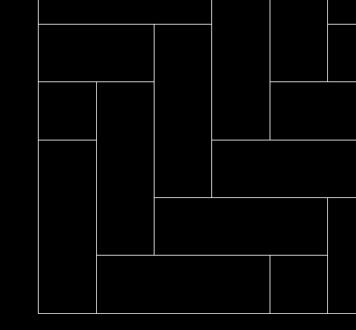

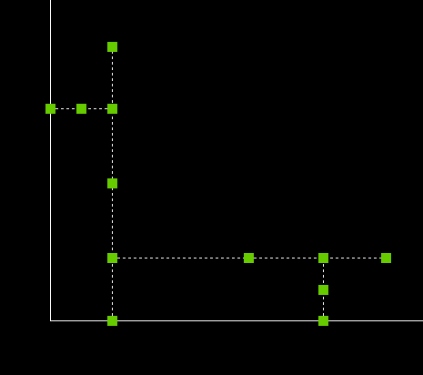

This is what I worked out from looking at the numbers.
1. Given a tile of length 'X' and width 'Y', I first of all factorize the numbers and then take the HCF (Highest Common Factor) and the LCM (Lowest common multiple) of X and Y.
2. Then using my trusty Hatch pattern diagram (see below), e  = HCF and f + g = 2 x LCM. Knowing that f = X + Y, then g = (2 x LCM) - f.
3. I started a reiterative process, using excel, where I had two columns   d and offset. The offset started at -e and the length at 0. I then tested if the offset was negative. If it was, I added X to d and Y to the offset. If the offset was positive, I added Y to d and subtracted Y from the offset. These steps went on until the offset was 0, which gave the required value of d.
4. Then the hatch pattern definition can be written (with appropriate headers):-
0,  0,  0,  d,  -e,  f,  -g
90, Y,  0,  d,  e,  f,  -g
There must be a blank line at the end of the file, and I have found that an asterisk is tolerated by Autocad and serves as a visual marker.
Edited by eldon
Corrected factor

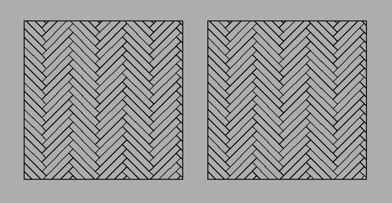

Previously, I had posted some herringbone patterns where the length and width were a simple proportion. So I thought to try out my general method of calculating.
I got different hatch pattern numbers, but they plot the same (different angles but tile size the same)
*Hb6, Herringbone with width to length ratio 1 to 6
45,0,0,1,1,7,-5
135,0,0,-1,1,6,-5,1
*eldon May 2022
*aatest, testing tile 6 x 1
0,0,0,11,-1,7,-5
90,1,0,11,1,7,-5
*eldon March 2023
Edited by eldon
better picture
