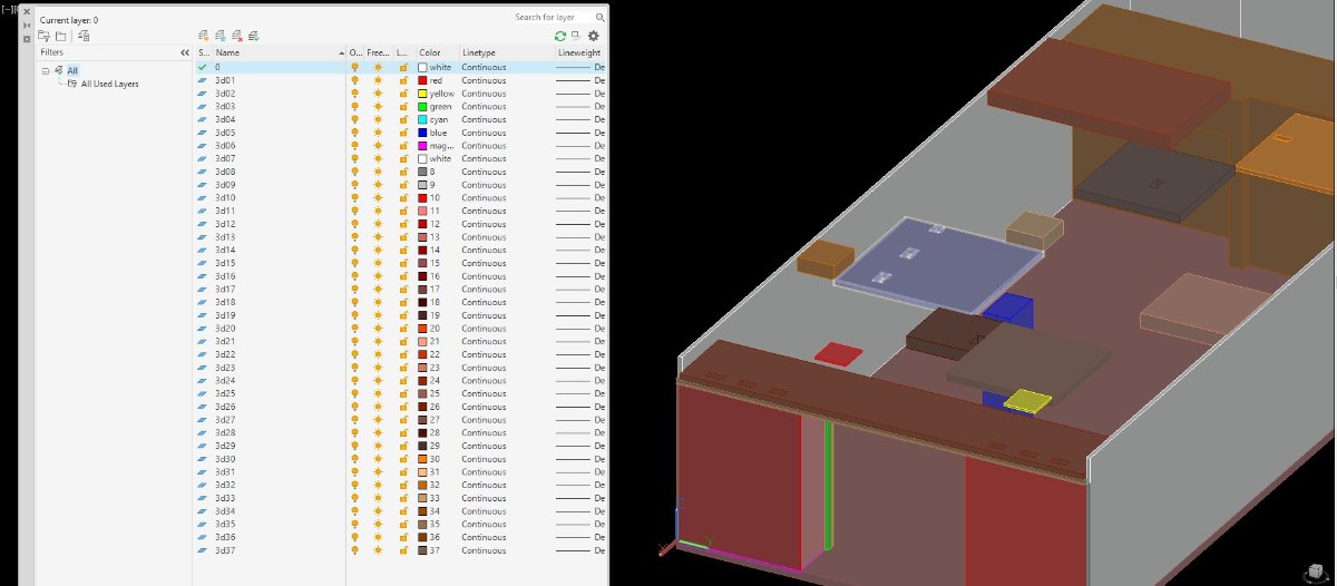

One last question, Is there a way that we could also save the file name to Layer name? As I mentioned before, each solid is put into a layer and layer name. This way When I end up with 300 dwg files, I know which file correspond to which layer. see snapshot attached
Change this :
fname (strcat (getvar 'dwgprefix) (itoa cnt) ".dwg")
To :
fname (strcat (getvar 'dwgprefix) (cdr (assoc 8 (entget (vlax-vla-object->ename obj)))) ".dwg")
