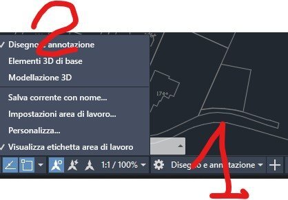

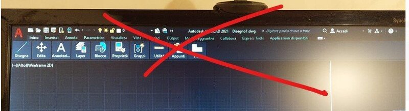

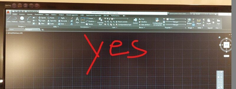

Giovannino60 Posted January 19, 2023 Posted January 19, 2023 Accidentally deleted the autocad 2021 bar and I can no longer put the autocad bar back like the one in the image, how can I go? Thank you Quote
Cad64 Posted January 19, 2023 Posted January 19, 2023 All you have to do is double click on the bar, where I'm showing in the image below. You may have to do this several times in order to get back to the ribbon interface. 3 Quote
Dadgad Posted January 20, 2023 Posted January 20, 2023 @Cad64 should have you all sorted out there. I believe that ROPEN (Ribbon Open) will also do it. By clicking where Cad64 suggested you can choose whether or not, or how you want the Ribbon to display. Quote
BIGAL Posted January 20, 2023 Posted January 20, 2023 Ribbon & inverse Ribbonclose should work. Quote
Cad64 Posted January 20, 2023 Posted January 20, 2023 11 hours ago, Giovannino60 said: I found this solution That changes your workspace. If you just want to change how the ribbon is displayed in your current workspace, simply double click on the bar as I showed in my previous reply. 2 Quote

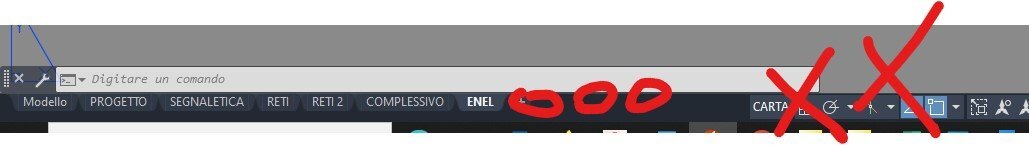

Giovannino60 Posted January 22, 2023 Author Posted January 22, 2023 How do I remove these buttons that I don't need to see more loyout space tabs? Thank you Quote
Cad64 Posted January 22, 2023 Posted January 22, 2023 Click on the little button at the far bottom right that looks like 3 horizontal lines. This will open a pop up menu where you can turn off the buttons you don't want. 2 Quote
Dana W Posted January 23, 2023 Posted January 23, 2023 (edited) Never mind. My post was redundant. Edited January 23, 2023 by Dana W Quote
Steven P Posted January 24, 2023 Posted January 24, 2023 On 1/22/2023 at 10:45 AM, Giovannino60 said: How do I remove these buttons that I don't need to see more loyout space tabs? Thank you I tend to turn the ribbon off for this reason - use old style menus - else I find the screen is filled with icons and you can't see your work 1 Quote
