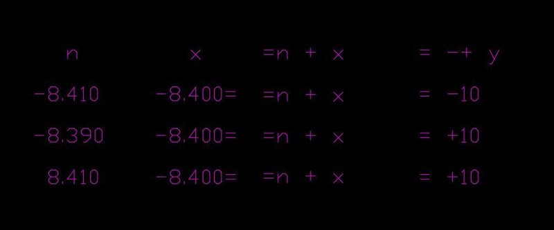

hello  ,
I am sorry for my English
Is there a lisp that can do something like the picture?
Changing the text and mtext by operating on the selected text and mtext
-Metric numbers in text and mtext     example  ; 10.025  , -10.025       (n)
-  add or subtract with the desired number       (x)
-  results can be millimetric (no decimal) and + - symbol       =
n - x  or n +x    =   + y or  -y
10.025   -10.000   =   +25
-10.025  +10.000   =  -25
As name implies -ve is ok.

thank you  ,
Multi GETVALS.lsp     works with lisp   ....
the result     for example    -0.005  or   0.005     ,,,     for these results to be like this    -5  or  +5 (with the + icon)
what do i need to change in lisp ?

10 hours ago, mhupp said:
thank you  ,
i have looked at this. but it deletes the decimal places    ... +0.010    > 0.01                   what i want    +0.010 >>   +10
2 hours ago, mhupp said:
Ah that's my bad thought these where the same.
https://cadtips.cadalyst.com/notestext/run-calculations-numerical-text-and-mtext
Allows you to pick how many decimal places you want. do your original math ± 8.400. Then you have to run again and multiple by 1000 to get  +0.010 >>   +10
thank you  ,
yes almost met my needs   ,,,
what to change to have + symbol at the start of positive results
Edited by thecocuk07
