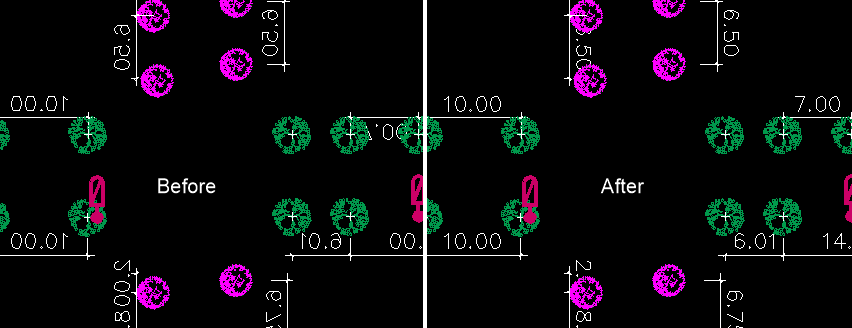

@SLW210 This isn't really a lisp issue its more of a interface one.

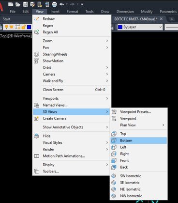

They were made when facing the wrong way (Bottom view I think). So their 210 looks like (210 0.0 0.0 -1.0)
This will mirror them around but the right way but also wont 100% fix the issue. because some will have to be adjusted.

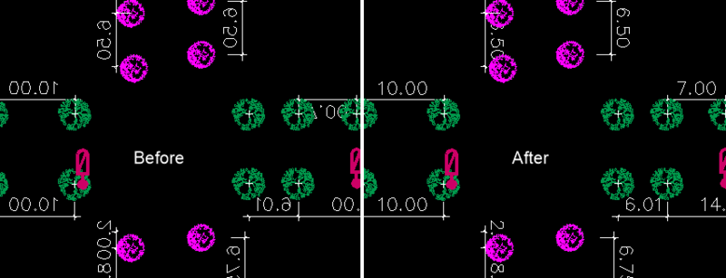

This is what it is, isn't it?
  • Agree 1
Yes, whomever was in that view when the dimension where made or they got flipped somehow. making them upside down when viewed from top
