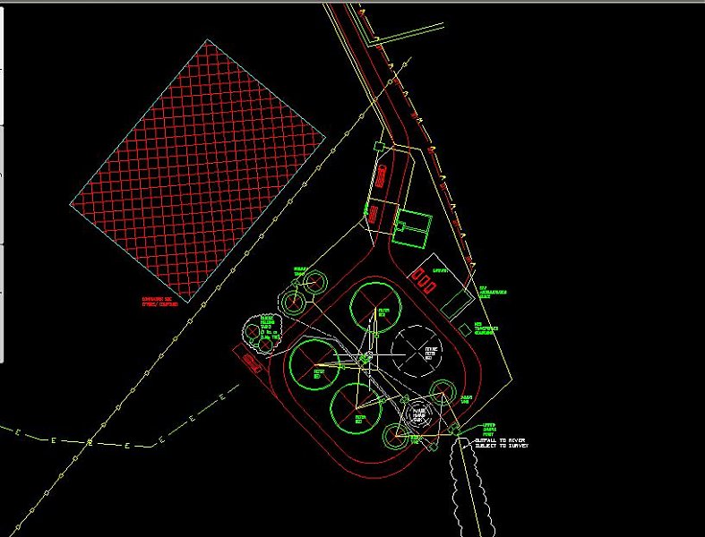

spittle Posted February 19, 2009 Posted February 19, 2009 I've never done this before so have a few queries. Attached are two JPEGs showing my proposed Site Layout and a section of the proposed access road. I have an existing 3D surface for the entire area (switched off for clarity). I now need to create a proposed surface. How hard would it be to create a C3D road following the exact curves of the one I have drawn in cad? (curves are defined by Autotrack akllow access for articulated vehicle) Currently I'd use feature lines to draw the road edge and model it into my surface but it's a rubbish way of working as when the layout changes it's a real ****** to move everything around. Ideally I'd like to: - model my proposed surface - grade this into my existing surface - then create a proposed access road (including the loop) - then grade this into both surfaces. - I'd then like to have the option to be able to rearrange my site layout and move my road to suit. Can I do this? Any tips would be appreciated. Or an 'in-a-nutshell' summary. Cheers Quote

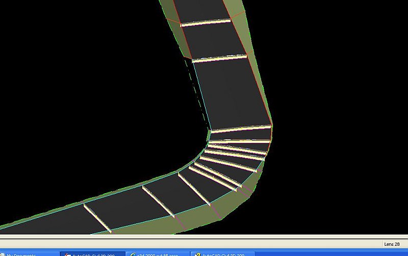

spittle Posted April 23, 2009 Author Posted April 23, 2009 I finally had time to create my first road corridor. Now I'm trying to create a coridor surface so that I can create a grid volume surface. It appears to create the corridor surface ok, but when I try to create the volume surface it says 'Error Creating Surface'. the only thing I can see as a potential error on my cut and fill for my corridor is there are a few gaps as you can see in the attached JPEG. Any ideas? The problem appears to occur when there is a transition between cut & fill. Quote
rustysilo Posted April 23, 2009 Posted April 23, 2009 Please explain how you went about creating the corridor and volume surfaces. As far as the gaps in the corridor it appears that maybe the corridor did not intersect the existing ground surface at those points/areas. Quote

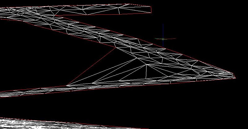

spittle Posted April 23, 2009 Author Posted April 23, 2009 I had a surface, I drew an alignment (Not using curves - I'm wondering if this is the culprit - though I don't think so) I created a long section for this alignment displaying my surface. I then drew my proposed road profile on my longsection I then turned the polylines indicating either side of my road into two more alignments (this time using curves) I then created an assembly, a bit of road, cut & fill, and then mirrorred them both. I created the corridor which cut and filled where it needed to. I then created a corridor surface. tried a Volume TIN, and it failed. Potential culprit I can think of is the gaps between the cut and fill off my road corridor. Attached is a JPEG showing how it looks in plan with my main surface's triangles turned on. Quote
spittle Posted April 23, 2009 Author Posted April 23, 2009 Here's another JPEG of my main surface rotated to show that the cut/fill should have intersected the main surface Quote

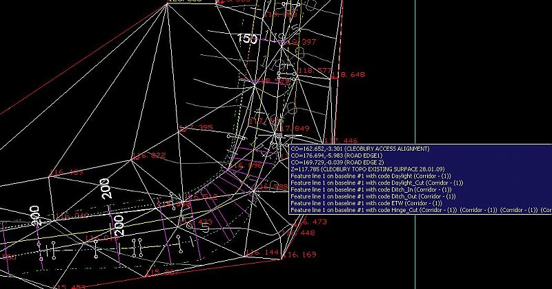

spittle Posted April 24, 2009 Author Posted April 24, 2009 I've had a thought... the subassemply part I used for the cut/fill on the edge of my road is the BasicSideSlopeCutDitch - "cut or fill daylight sideslopes with a ditch in cut situations". I didn't want the ditch and couldn't see a standard cut/fill sub assembly so I just set those perameters to 0 width. I'm thinking though perhaps the trouble spots are because the ditch can't grade to the cut? I really don't know what the problem is. I tried a curved alignment without success so have reverted back to the original one. Quote
rustysilo Posted April 24, 2009 Posted April 24, 2009 You might be on to something with that thought. Quote
spittle Posted April 27, 2009 Author Posted April 27, 2009 All sorted - the problem was under my surface tab in Corridor Properties I hadn't added a link to the surface. I don't understand exactly what I did, but I added a link to TOP and it worked. The solution was found on theswamp forum. Quote
