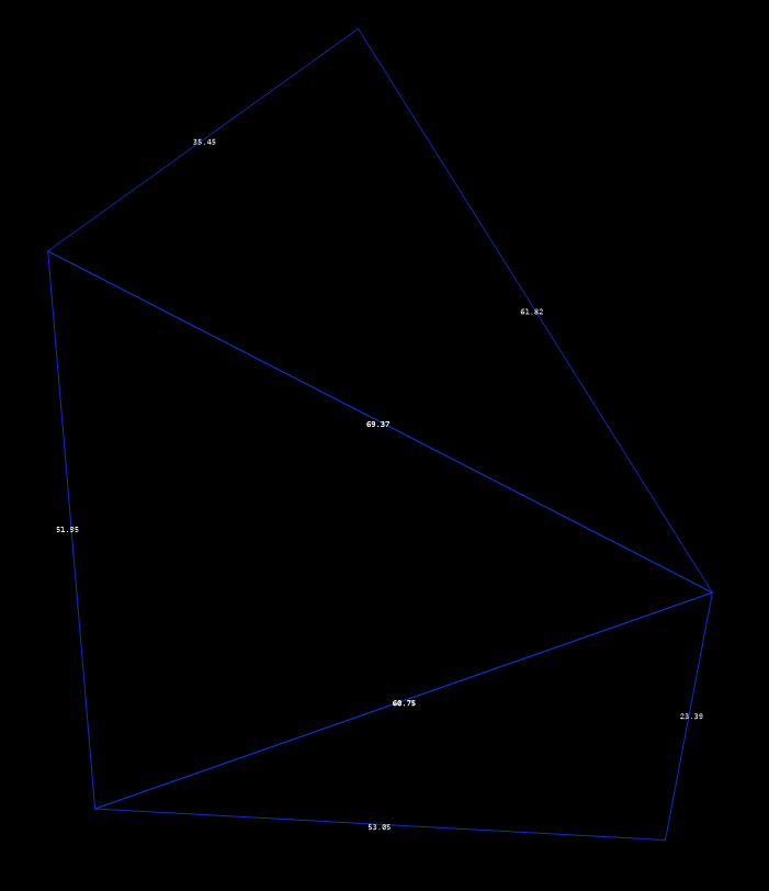

Guest Posted January 10, 2023 Posted January 10, 2023 Hi , I am using this code for dimension open/close polylines. Sometimes I have to dimension multiple close polylines like the attach file, and for the same side of the polygon have duplicate dimensions (one for each polygon). I need help to update the code a) Select multiple polylines (not one every time) b) Don't have duplicate dimensions ;qq.lsp ; ;****************************************************** (Defun C:qq (/ txtstl txtsze stryn prfx sufx svr scl ht pt pti ptx pty old oldpl nodpl ptyp pllst i n prin meta distmeta ptdist angprin angmeta angtxt ptp alfa nlin xlin ylin dlin flg xreg yreg na xa ya) ;*************drawing set-up*************************** ; (command "undo" "m") (setvar "unitmode" 0) (setvar "aunits" 2) (setvar "angbase" (/ pi 2)) (setvar "angdir" 1) (setvar "auprec" 4) (setvar "lunits" 2) (setvar "luprec" 3) (setvar "dimzin" 0) (setq svr(getvar "osmode")) (setq txtstl(getvar "textstyle")) (setq txtsze(getvar "textsize")) (setvar "cmdecho" 0) (setq flg 1) (setvar "cmdecho" 0) (command "layer" "m" "diast" "") (setq scl(/ (getreal "\n select scale (100,200,500,etc) : ") 100)) (setq ht(* 0.175 scl)) :********BOUNDARY LINE********** (setvar "osmode" 0) (setq old(entsel "\n select lwpolyline: ")) (setq oldpl(entget(car old))) (setq nodpl(cdr(assoc 90 oldpl))) (setq ptyp (cdr(assoc 70 oldpl))) (command "area" "e" old) (setq pllst '()) (setq i 0) (setq n 0) (while (car(nth i oldpl)) (if (= (car(nth i oldpl)) 10) (progn (setq pllst (append pllst (list (cdr(nth i oldpl))))) (setq n(+ 1 n)) );endprogn );endif (setq i (+ i 1)) );endwhile (if (= ptyp 1) (progn (setq pllst (append pllst (list(nth 0 pllst)))) (setq pllst (cdr pllst)) );endprogn );endif ; (main) ;close defun ;(defun main() ;*******CIRCLES ON LANDMARKS*********** (command "style" "diast" "wgsimpl.shx" "" "" "" "" "") (setq alfa 193) (command "circle" pt (/ ht 5)) (command "copy" pt "" "m" pt) (foreach n pllst (command n)) (command "") (command "erase" pt "") (setq i 0 prin 0 meta 0) (while (car(nth i pllst)) (setq prin (- i 1)) (setq meta (+ i 1)) (if (= i 0) (setq prin (- n 1)) ) (if (= i (- n 1)) (setq meta 0) ) (setq angprin (angle (nth i pllst) (nth prin pllst))) (setq angmeta (angle (nth i pllst) (nth meta pllst))) (setq distmeta (distance (nth i pllst) (nth meta pllst))) ;**************DISTANCES BETWEEN LANDMARKS********************** (setq ptdist (polar (polar (nth i pllst) angmeta (/ distmeta 2)) (+ angmeta (* (/ pi 2) flg)) (* 0.25 ht))) (setq angtxt(- 500 (/ (* 400 angmeta) (* 2 pi)))) (if (> angtxt 400) (setq angtxt (- angtxt 400)) ) (if (> angtxt 200) (progn (setq ptdist (polar (polar (nth i pllst) angmeta (/ distmeta 2)) (+ angmeta (* (/ pi 2) flg)) (* 1.25 ht))) (setq angtxt (- angtxt 200)) );endprogn ) (command "text" "j" "c" ptdist ht angtxt (rtos distmeta 2 2) ) (setq i (+ i 1)) );endwhile (if (= ptyp 0) (command "erase" "l" "") ) ;********** ; (initget "Yes No") ; (setq stryn(getkword "\nSatisfied? (Yes or No) :")) ; (if (= stryn "Yes") ; (ok) ; );end if ; (if (= stryn "No") ; (progn ; (command "undo" "b") ; (command "undo" "m") ; (setq flg(* -1 flg)) ; (main) ; ) ; );end if ; (ok) ;close defun ;(defun ok () ;*********END*********************************** (setvar "osmode" svr) (setvar "cmdecho" 1) (setvar "textstyle" txtstl) (setvar "textsize" txtsze) (princ) );close defun Thanks Drawing1.dwg Quote

Guest Posted January 13, 2023 Posted January 13, 2023 I clean a little more the code. Any ideas how to fix the text angle? (defun c:foo( / *error* a acdoc b c d scl e fd ht i o p1 p2 p3 pc pm rad sd space ss u opt isLine) ;------------Dont delete it, i use it for the text height, I deactivate it for the moment ---------------- ; (setq scl (getvar "useri1")) ; (setq ht (* 0.00175 scl)) ;--------------------------------------------------------------------------------------------------------------------- (command "-style" "diast" "wgsimpl.shx" "0" "1" "0" "N" "N" "N") (command "_layer" "_m" "DIM-TEXT" "_c" "93" "" "_lw" "0.30" "" "") (setq acDoc (vla-get-activedocument (vlax-get-acad-object)) space (vlax-get acDoc (if (= (getvar 'cvport) 1) 'paperspase 'modelspace)) ht (* 1.0 (getvar 'dimtxt) (if (= 0 (getvar 'dimanno)) (getvar 'dimscale) (/ 1.0 (getvar 'cannoscalevalue)))) ) (vla-startundomark acDoc) (defun *error* (msg) (and msg (not (wcmatch (strcase msg) "*CANCEL*,*QUIT*,*BREAK*")) (princ (strcat "\nADError: " msg)) ) (vla-endundomark acdoc) (princ) ) (if (setq ss (ssget '((0 . "LWPOLYLINE,LINE,ARC")))) (repeat (setq i (sslength ss)) (setq e (ssname ss (setq i (1- i))) o (vlax-ename->vla-object e) a (vlax-curve-getstartparam e) c (vlax-curve-getendparam e) b nil isLine (wcmatch (vla-get-Objectname o) "AcDbLine,AcDbArc") ) (while (<= (setq b (if isLine (if b (1+ b) c) (1+ a))) c) (setq p1 (vlax-curve-getpointatparam e a) p2 (vlax-curve-getpointatparam e b) u (angle p1 p2) pm (vlax-curve-getpointatparam e (/ (+ a b) 2.0)) sd (vlax-curve-getsecondderiv e (/ (+ a b) 2.0)) rad (distance '(0 0 0) sd) d (cond (isLine) ((not (minusp (vla-getbulge o a))))) pc (mapcar (if d '+ '-) pm sd) p3 (if (or (equal rad 0.0 1e-8) (eq (cadr opt) "c2")) (if (eq (car opt) "b0") (polar pm (+ (atan (/ (sin u) (cos u))) (/ pi 2.0)) ht) (polar pm (- (atan (/ (sin u) (cos u))) (/ pi 2.0)) (* 1.75 ht)) ) (if (eq (cadr opt) "c0") (polar pm (angle pm pc) (if (<= 1e-4 (angle pc pm) pi) (* 1.75 ht) ht)) (polar pm (angle pc pm) (if (<= 1e-4 (angle pc pm) pi) ht (* 1.75 ht))) ) ) ) (entmake (list (cons 0 "TEXT") (cons 10 p3) (cons 11 p3) (cons 40 ht) (cons 1 (rtos (distance p1 p2) 2 2)) '(7 . "diast") '(8 . "DIM-TEXT") '(73 . 2) '(72 . 1))) (setq a (1+ a)) ) ) ) (vla-endundomark acdoc) (princ) ;layer 0 (mapcar 'setvar '("clayer" "cecolor" "celtype" "celweight") (list "0" "BYLAYER" "BYLAYER" -1)) (princ) );close defun (defun getdictvar (dict var / dict_ename) (if (setq dict_ename (cdr (assoc -1 (dictsearch (namedobjdict) dict)))) (cdr (assoc 1 (dictsearch dict_ename var))) ) ) (defun setdictvar (dict var val / dict_name record) (or (setq dict_ename (cdr (assoc -1 (dictsearch (namedobjdict) dict)))) (setq dict_ename (dictadd (namedobjdict) dict (entmakex '((0 . "DICTIONARY") (100 . "AcDbDictionary"))))) ) (if (setq record (dictsearch dict_ename var)) (entmod (subst (cons 1 val) (assoc 1 record) record)) (dictadd dict_ename var (entmakex (list '(0 . "DICTIONARYVAR") '(100 . "DictionaryVariables") '(280 . 0) (cons 1 val) ) ) ) ) val ) Thanks test(1).dwg Quote

Guest Posted January 14, 2023 Posted January 14, 2023 (edited) Hi, I update the code and correct the angle problem for the text. Work for multiple polylines. I have these problems : 1) I don't know haw to delete duplicate text 2) The dimension are not all inside the polygon (defun c:foo( / *error* a acdoc b c d scl e fd ht i o p1 p2 p3 pc pm rad sd space ss u opt isLine) ;------------Dont delete it, i use it for the text height, I deactivate it for the moment ---------------- ; (setq scl (getvar "useri1")) ; (setq ht (* 0.00175 scl)) ;--------------------------------------------------------------------------------------------------------------------- (command "-style" "diast" "wgsimpl.shx" "0" "1" "0" "N" "N" "N") (command "_layer" "_m" "DIM-TEXT" "_c" "93" "" "_lw" "0.30" "" "") (setq acDoc (vla-get-activedocument (vlax-get-acad-object)) space (vlax-get acDoc (if (= (getvar 'cvport) 1) 'paperspase 'modelspace)) ht (* 1.0 (getvar 'dimtxt) (if (= 0 (getvar 'dimanno)) (getvar 'dimscale) (/ 1.0 (getvar 'cannoscalevalue)))) ) (vla-startundomark acDoc) (defun *error* (msg) (and msg (not (wcmatch (strcase msg) "*CANCEL*,*QUIT*,*BREAK*")) (princ (strcat "\nADError: " msg)) ) (vla-endundomark acdoc) (princ) ) (setq opt (mapcar '(lambda (a b) (cond ((getdictvar "AD_otions" a)) ((setdictvar "AD_otions" a b)) ) ) '("Linear" "Arc") '("b0" "c0") ) ) (if (setq ss (ssget '((0 . "LWPOLYLINE,LINE,ARC")))) (repeat (setq i (sslength ss)) (setq e (ssname ss (setq i (1- i))) o (vlax-ename->vla-object e) a (vlax-curve-getstartparam e) c (vlax-curve-getendparam e) b nil isLine (wcmatch (vla-get-Objectname o) "AcDbLine,AcDbArc") ) (while (<= (setq b (if isLine (if b (1+ b) c) (1+ a))) c) (setq p1 (vlax-curve-getpointatparam e a) p2 (vlax-curve-getpointatparam e b) u (angle p1 p2) pm (vlax-curve-getpointatparam e (/ (+ a b) 2.0)) sd (vlax-curve-getsecondderiv e (/ (+ a b) 2.0)) rad (distance '(0 0 0) sd) d (cond (isLine) ((not (minusp (vla-getbulge o a))))) pc (mapcar (if d '+ '-) pm sd) p3 (if (or (equal rad 0.0 1e-8) (eq (cadr opt) "c2")) (if (eq (car opt) "b0") (polar pm (+ (atan (/ (sin u) (cos u))) (/ pi 2.0)) ht) (polar pm (- (atan (/ (sin u) (cos u))) (/ pi 2.0)) (* 1.75 ht)) ) (if (eq (cadr opt) "c0") (polar pm (angle pm pc) (if (<= 1e-4 (angle pc pm) pi) (* 1.75 ht) ht)) (polar pm (angle pc pm) (if (<= 1e-4 (angle pc pm) pi) ht (* 1.75 ht))) ) ) ) (entmake (list (cons 0 "TEXT") (cons 10 p3) (cons 11 p3) (cons 40 ht) (cons 50 u) (cons 1 (rtos (distance p1 p2) 2 2)) '(7 . "diast") '(8 . "DIM-TEXT") '(73 . 2) '(72 . 1))) (setq a (1+ a)) ) ) ) (vla-endundomark acdoc) (princ) ;layer 0 (mapcar 'setvar '("clayer" "cecolor" "celtype" "celweight") (list "0" "BYLAYER" "BYLAYER" -1)) (princ) (princ) );close defun (defun getdictvar (dict var / dict_ename) (if (setq dict_ename (cdr (assoc -1 (dictsearch (namedobjdict) dict)))) (cdr (assoc 1 (dictsearch dict_ename var))) ) ) (defun setdictvar (dict var val / dict_name record) (or (setq dict_ename (cdr (assoc -1 (dictsearch (namedobjdict) dict)))) (setq dict_ename (dictadd (namedobjdict) dict (entmakex '((0 . "DICTIONARY") (100 . "AcDbDictionary"))))) ) (if (setq record (dictsearch dict_ename var)) (entmod (subst (cons 1 val) (assoc 1 record) record)) (dictadd dict_ename var (entmakex (list '(0 . "DICTIONARYVAR") '(100 . "DictionaryVariables") '(280 . 0) (cons 1 val) ) ) ) ) val ) Can any one help ? Thanks Edited January 14, 2023 by prodromosm Quote
Guest Posted January 14, 2023 Posted January 14, 2023 Hi, I update the code to delete the duplicate dimension. Can anyone help me to fix dimensions to be all inside the polygon? Like the example? (defun c:foo3 ( / *error* a acdoc b c d scl e fd ht i o p1 p2 p3 pc pm rad sd space ss u opt isLine) ;------------Dont delete it, i use it for the text height, I deactivate it for the moment ---------------- ; (setq scl (getvar "useri1")) ; (setq ht (* 0.00175 scl)) ;--------------------------------------------------------------------------------------------------------------------- (command "-style" "diast" "wgsimpl.shx" "0" "1" "0" "N" "N" "N") (command "_layer" "_m" "DIM-TEXT" "_c" "93" "" "_lw" "0.30" "" "") (setq acDoc (vla-get-activedocument (vlax-get-acad-object)) space (vlax-get acDoc (if (= (getvar 'cvport) 1) 'paperspase 'modelspace)) ht (* 1.0 (getvar 'dimtxt) (if (= 0 (getvar 'dimanno)) (getvar 'dimscale) (/ 1.0 (getvar 'cannoscalevalue)))) ) (vla-startundomark acDoc) (defun *error* (msg) (and msg (not (wcmatch (strcase msg) "*CANCEL*,*QUIT*,*BREAK*")) (princ (strcat "\nADError: " msg)) ) (vla-endundomark acdoc) (princ) ) (if (setq ss (ssget '((0 . "LWPOLYLINE,LINE,ARC")))) (repeat (setq i (sslength ss)) (setq e (ssname ss (setq i (1- i))) o (vlax-ename->vla-object e) a (vlax-curve-getstartparam e) c (vlax-curve-getendparam e) b nil isLine (wcmatch (vla-get-Objectname o) "AcDbLine,AcDbArc") ) (while (<= (setq b (if isLine (if b (1+ b) c) (1+ a))) c) (setq p1 (vlax-curve-getpointatparam e a) p2 (vlax-curve-getpointatparam e b) u (angle p1 p2) pm (vlax-curve-getpointatparam e (/ (+ a b) 2.0)) sd (vlax-curve-getsecondderiv e (/ (+ a b) 2.0)) rad (distance '(0 0 0) sd) d (cond (isLine) ((not (minusp (vla-getbulge o a))))) pc (mapcar (if d '+ '-) pm sd) p3 (if (or (equal rad 0.0 1e-8) (eq (cadr opt) "c2")) (if (eq (car opt) "b0") (polar pm (+ (atan (/ (sin u) (cos u))) (/ pi 2.0)) ht) (polar pm (- (atan (/ (sin u) (cos u))) (/ pi 2.0)) (* 1.75 ht)) ) (if (eq (cadr opt) "c0") (polar pm (angle pm pc) (if (<= 1e-4 (angle pc pm) pi) (* 1.75 ht) ht)) (polar pm (angle pc pm) (if (<= 1e-4 (angle pc pm) pi) ht (* 1.75 ht))) ) ) ) (entmake (list (cons 0 "TEXT") (cons 10 p3) (cons 11 p3) (cons 40 ht) (cons 50 u) (cons 1 (rtos (distance p1 p2) 2 2)) '(7 . "diast") '(8 . "DIM-TEXT") '(73 . 2) '(72 . 1))) (setq a (1+ a)) ) ) ) (vla-endundomark acdoc) (princ) ;layer 0 (mapcar 'setvar '("clayer" "cecolor" "celtype" "celweight") (list "0" "BYLAYER" "BYLAYER" -1)) (princ) (c:FText) (princ) );close defun (defun getdictvar (dict var / dict_ename) (if (setq dict_ename (cdr (assoc -1 (dictsearch (namedobjdict) dict)))) (cdr (assoc 1 (dictsearch dict_ename var))) ) ) (defun setdictvar (dict var val / dict_name record) (or (setq dict_ename (cdr (assoc -1 (dictsearch (namedobjdict) dict)))) (setq dict_ename (dictadd (namedobjdict) dict (entmakex '((0 . "DICTIONARY") (100 . "AcDbDictionary"))))) ) (if (setq record (dictsearch dict_ename var)) (entmod (subst (cons 1 val) (assoc 1 record) record)) (dictadd dict_ename var (entmakex (list '(0 . "DICTIONARYVAR") '(100 . "DictionaryVariables") '(280 . 0) (cons 1 val) ) ) ) ) val ) ;; This code delete duplicate text (defun c:FText (/ ent ent1 i lst newlayer ofset ss ss1 ss_tmp ans) (defun GetBound (ent ofs / ang elist ll lr tb tb1 tb2 ul ur) (setq elist (entget ent) ang (cdr (assoc 50 elist)) tb (textbox elist) tb1 (car tb) tb2 (cadr tb) ll (polar (cdr (assoc 10 elist)) (+ (angle '(0 0) tb1) ang) (DISTANCE '(0 0) tb1) ) lr (polar ll ang (- (car tb2) (car tb1))) ur (polar ll (+ ang (angle tb1 tb2)) (distance tb1 tb2)) ul (polar ll (+ ang (/ pi 2)) (- (cadr tb2) (cadr tb1))) ) (setq ang (angle ll lr)) (setq ll (polar ll (- ang (* pi 0.75)) (sqrt (* (* ofs ofs) 2))) lr (polar lr (- ang (/ pi 4)) (sqrt (* (* ofs ofs) 2))) ur (polar ur (+ ang (/ pi 4)) (sqrt (* (* ofs ofs) 2))) ul (polar ul (+ ang (* pi 0.75)) (sqrt (* (* ofs ofs) 2))) ) (list ll lr ur ul) ) (command "_.undo" "be") (setq ss (ssget "_X" (list (cons 0 "TEXT")(cons 8 "DIM-TEXT"))) ss1 (ssadd)) (setq *ofset 0.5) (initget 4) (if (= ofset nil) (setq ofset *ofset) (setq *ofset ofset) ) (while (> (sslength ss) 0) (setq ent (ssname ss 0) lst (GetBound ent ofset) ) (ssdel ent ss) (if (setq ss_tmp (ssget "cp" lst (list (cons 0 "TEXT")))) (progn (setq i -1) (while (setq ent1 (ssname ss_tmp (setq i (1+ i)))) (if (not (equal ent ent1)) (progn (ssadd ent1 ss1) (if (ssmemb ent1 ss) (ssdel ent1 ss) ) ) ) ) ) ) ) (command ".erase" ss1 "") (command "_.undo" "e") (princ) ) test.dwg Quote
1958 Posted January 15, 2023 Posted January 15, 2023 Multiple selection and removal of duplicates 747.LSP Quote
Guest Posted January 15, 2023 Posted January 15, 2023 Hi 1958. I try your code but, 1) I use text not mtext 2)The bigger problem is that the half of the dimensions are out of the polygon. I am trying to find a way all the dimension be inside the polygon. All the polyline in my drawings are counterclockwise. Thanks Quote
1958 Posted January 15, 2023 Posted January 15, 2023 polyline segment length label (text, non-multiline text) signatures of common parties are not removed 767.LSP 1 Quote
