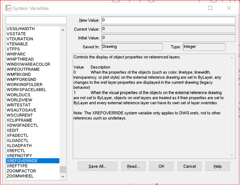

Go into your SYSVDLG ...System Value Dialog and check your settings for these Variables XEDIT through XREFOVERRIDE.
Use your Cursor button to easily and quickly scroll down through them, to familiarize yourself with what they impact.   :thumbsup:
