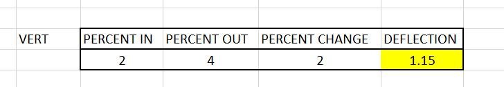

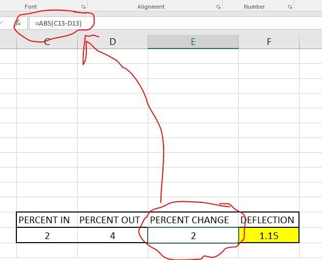

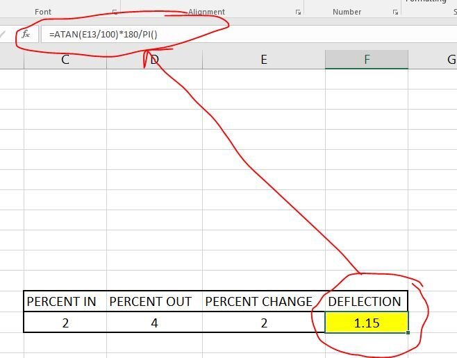

QuinnL Posted January 6, 2023 Share Posted January 6, 2023 Hey guys, Any ideas on making a custom script or block to calculate pipe deflection given two pipe slopes. We are currently use an excel sheet that works great, but I am curious if I could somehow convert it to work with Civil3D. I will include snips of the excel sheet we are currently using as reference. Quote Link to comment Share on other sites More sharing options...
BIGAL Posted January 7, 2023 Share Posted January 7, 2023 Its just a formula converted to a lisp calc. Two common functions are RTD and DTR ;The dtr function converts degrees to radians ;The rtd function converts radians to degrees (defun dtr (a) (* pi (/ a 180.0)) ) ; (defun rtd (a) (/ (* a 180.0) pi) ) These are always handy to have and most experienced coders will have these in an autoload lisp. So your request becomes (setq def (rtd (atan (/ (abs (- in out)) 100.)))) So input, in and out and get a result. Or (setq def (rtd (atan (/ (abs (- (getreal "\nEnter in value ")(getreal "\nEnter out value " ))) 100.)))) 1 Quote Link to comment Share on other sites More sharing options...
