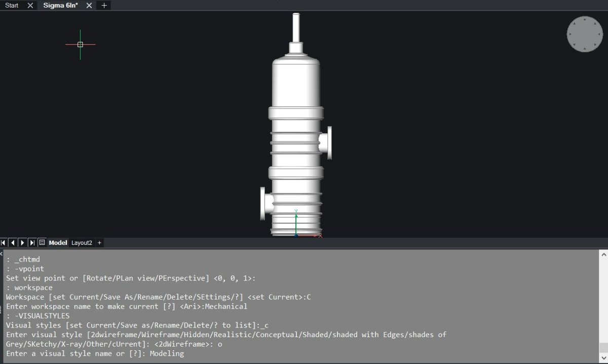

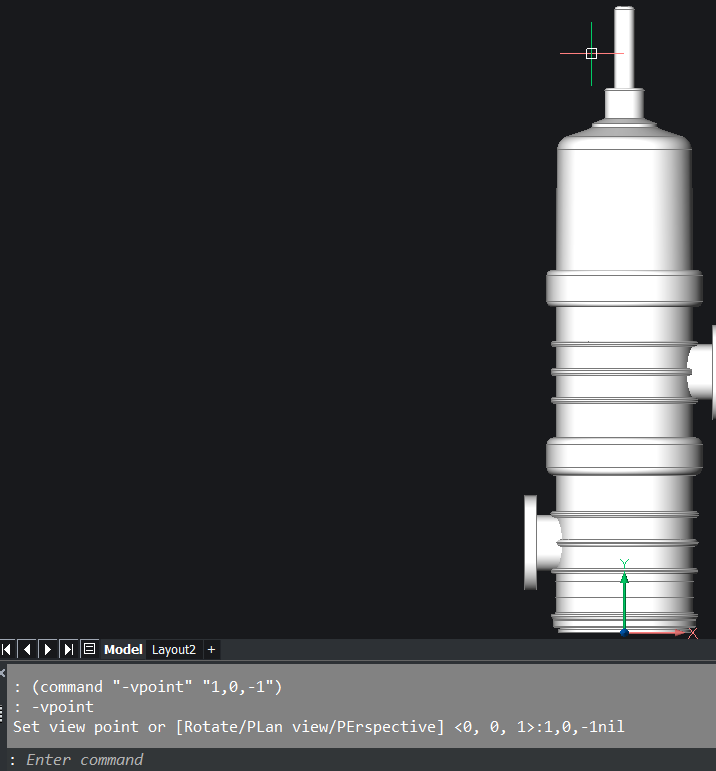

aridzv Posted January 6, 2023 Posted January 6, 2023 (edited) Hi. I'm trying to set the view point to "TOP-FRONT-RIGHT" with this line of code in my lisp: (command-s "-vpoint" "1, 0, -1");;change view point to "TOP-FRONT-RIGHT" but I'm getting this massege: : (command-s "-vpoint" "1, 0, -1") : -vpoint Set view point or [Rotate/PLan view/PErspective] <0, 0, 1>:1, 0, -1nil what am i doing wrong?... thanks, aridzv. Edited January 6, 2023 by aridzv Quote
mhupp Posted January 6, 2023 Posted January 6, 2023 This feeds it a list rather then a string. (command-s "-vpoint" '(1 0 -1)) Quote
aridzv Posted January 6, 2023 Author Posted January 6, 2023 @mhupp thanks. I've tried it (actually I've tried it before posting this qution..) and getting the same error: : (command-s "-vpoint" '(1 0 -1)) : -vpoint Set view point or [Rotate/PLan view/PErspective] <0, 0, 1>:nil why is that?... Quote

aridzv Posted January 6, 2023 Author Posted January 6, 2023 strangly it dosen't want to work... 1. here is the full lisp tht I'm using: (defun c:chtmd () (command "workspace" "C" "Mechanical") (princ) (command "-VISUALSTYLES" "_c" "o" "Modeling") ;; change visual style to modeling (princ) (command-s "-vpoint" '(1 -1 1)) ;; CHANGE VIEWPORT TO "TOP-FRONT-RIGHT" (princ) (SETVAR "UCSDETECT" 3) (SETVAR "QUADDISPLAY" 5) (princ) ) second, see the attached screenshot: the lisp change the work space to Mechanical and the VISUALSTYLE to modeling, but fail to change the viewpoint... aridzv Quote
aridzv Posted January 6, 2023 Author Posted January 6, 2023 (edited) 58 minutes ago, ronjonp said: *Post removed* .. bad suggestion. good one.... And on a slightly more serious note: I move a lot between workspaces, and in each transition I need to perform three main actions: 1. changing the workspace. 2. changing the Visual style. 3. changing the point of view. and on top of that also to change two variables. A total of 5 actions. The intention is to save those five actions and reduce them to one mouse click. aridzv Edited January 6, 2023 by aridzv Quote
BIGAL Posted January 6, 2023 Posted January 6, 2023 Simple answer remove the spaces in your xyz then it will work. (command "-vpoint" "1,0,-1") Quote
aridzv Posted January 6, 2023 Author Posted January 6, 2023 24 minutes ago, BIGAL said: Simple answer remove the spaces in your xyz then it will work. (command "-vpoint" "1,0,-1") that was my firs try.... nop,it dosen't... Quote
