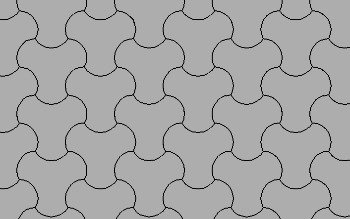

Not wanting the brain to atrophy over the holiday season. I thought to post a hatch pattern that I have called Trilobe-E. I expect others can make a hatch pattern faster with various tools, but I like to use Autocad and trigonometry (in a spread sheet). It was based on a unit sized hexagon.
As the grid is a hexagonal one instead of an orthogonal one, the brain was given good exercise.
I am posting the text of the file as well as the pattern file.

*eldon fecit MMXXIII
Trilobe-E.pat

Very interesting pattern and works perfectly in SolidWorks as well...

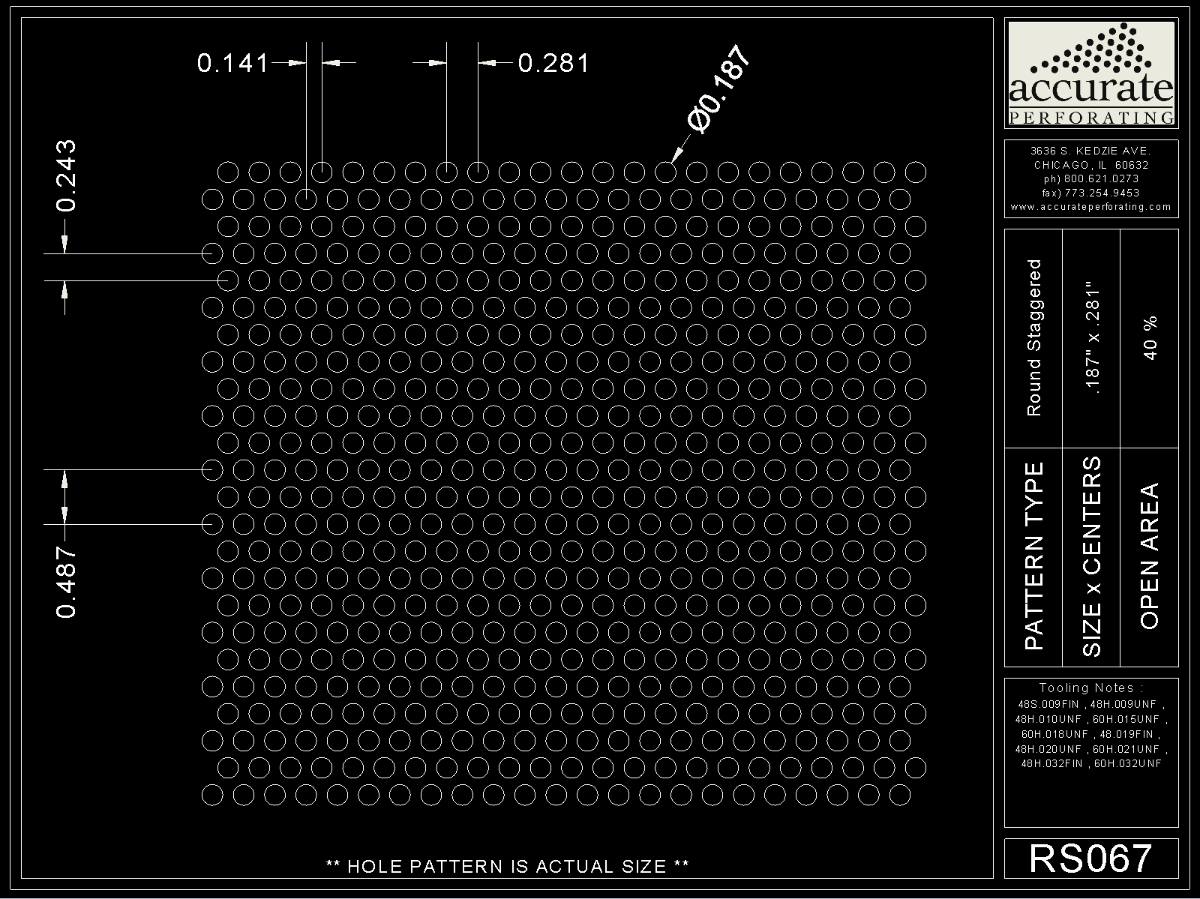

FYI, I have tried to get ChatGPT to create some patterns while in search of creating hatches to simulate perforated sheet... ChatGPT failed in all attempts so far to create a hatch pattern of dodecagons... For that, I have not attempted it, but it does seem to be a simple exercise.
Do you think it's an easy exercise to create dodecagon hatch patterns with different percentages of open area?
@SWDivad, I am glad the pattern works for you.
The trouble I see with using a hatch pattern for your need , is that at the edges, there would be part holes. So the hatch would not be able to reproduce your picture above. If it were easy to do, then I expect there would be plenty of hatches available!
The secret in writing hatch definitions is to accurately calculate the exact position of the next node in the direction of a line, and slightly alter the angle to give a perfect landing. With the limitations of significant figures and the limitation of the number of characters in a single line, there can be a variation of the position of the lines when far from the origin - have a look at the AutoCAD concrete hatch pattern.
Anyway, this topic might be of interest to you. But why limit the "circle" to 12 sides? I wrote a pattern for a 32 sided "circle" (icosidodecagon or triacontadigon). It took time and I don't know whether the eye could appreciate the difference. If such a porosity pattern were to be written, I see no problem in scaling certain linear parts of the definition as the angular numbers would be the same.
