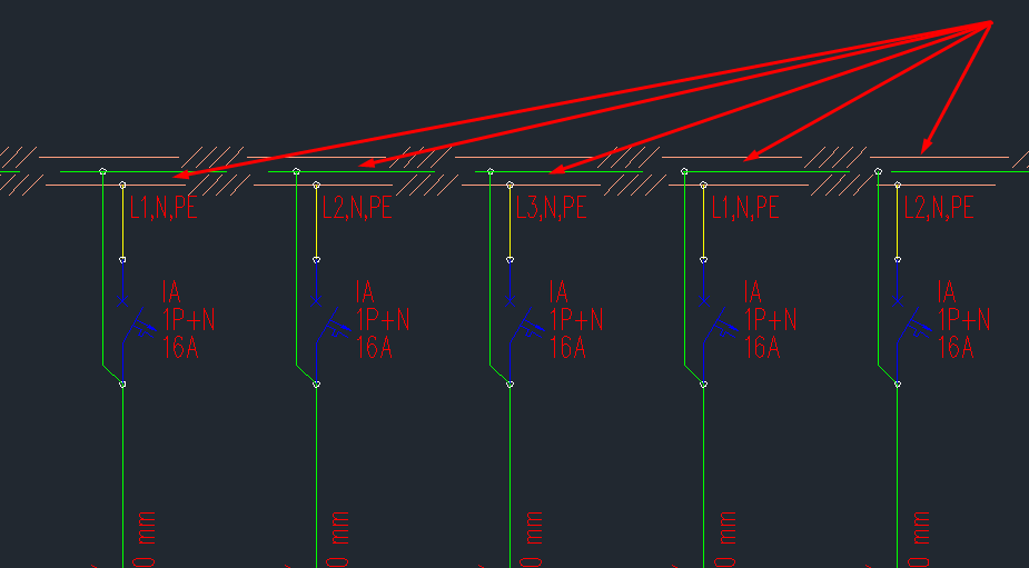

Hi all,
Can someone help me with a programming solution for the loop below?
I am trying to change the values "L1", "L2" and "L3" in a repeatable loop as seen in the image.
Below I put a part of the program that refers to my problem, but, as you can see, it doesn't work.
Thanks for the help.

This will allow you to pick multiple text at once. so pick all the ones you want to start with L1, then L2 and so on.
(defun c:FOO ()
  (vl-load-com)
  (setq i 1)
  (while (< i 4)
    (prompt (strcat "\nPick L" (rtos i 2 0)))
    (if (setq ss (ssget '((0 . "TEXT"))))
      (foreach ent (vl-remove-if 'listp (mapcar 'cadr (ssnamex SS)))
        (vla-put-textstring (vlax-ename->vla-object ent) (strcat "L" (rtos i 2 0) ",N,PE"))
    (setq i (1+ i))
Thanks for the promptness.
Can the program code be made so that I can select all the texts "Lx,N,PE" and change them automatically using a multiple of 3 (L1, L2 and L3) and select the text that starts with L1?
Many thanks.
