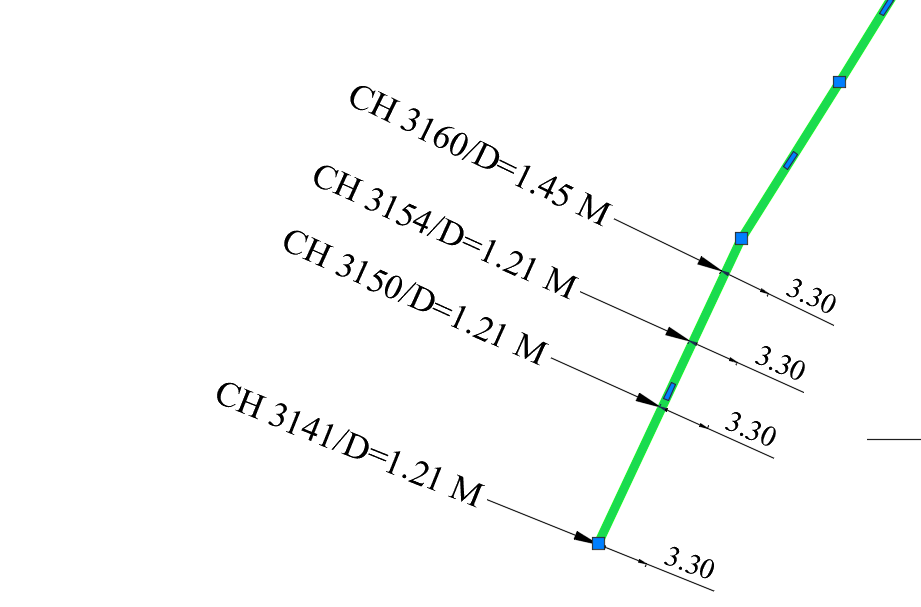

is their any way to add vertex between leader and polyline in one go at multiple location.
Before:-

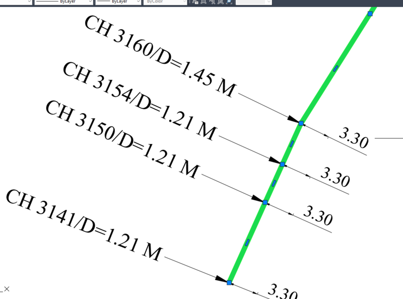

After

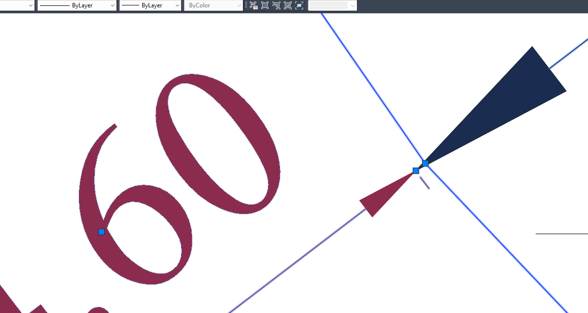

I made something
But with my test dwg it reacts a bit weird: it changes the location of the tip of the leader; because that leader is associated with the polyline.
Can you see if it works for you?
And anyone, feel free to step in.
Command PAVAL (for Polyline Add Vertex At Leader)

Great thanks working fine
