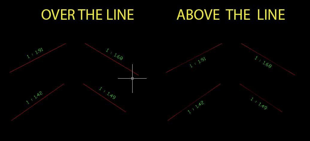

Hi, I am using this code to inset ratio slope  text. I want to do a change to this code.
1) after pick the line or point1 point2 ----> then not pick point3 to insert the text, but insert align in the middle of the line automatic
2) Give an option to over or above the line

Am sure you had the text centre aligned here?
Easiest for the text alignment I think is make the text insertion point the same, the middle of the line but create the text either top centre or bottom centre to match what you want
I reckon you should also have somewhere a LISP that asked for user input which you can modify to ask "Above or Below Line", perhaps read up on initget with the next line containing getkeyword to limit the opti0ns to what you want.
Have a go and ask where you need more specific advice, or for us to look over the code if you make an error

I dont know if is  any way to have an option  to insert text not only over the line but above   [over/ above]
