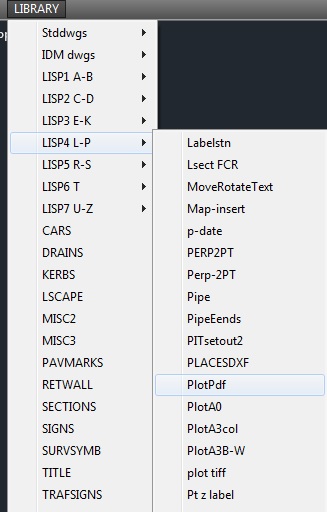

As you mentioned 70 lines you can have pop out menus using -> and <- to close. You can pop pop menu's not limited to 1 deep.
***POP20
**CADLIB
             [LIBRARY]
             [->Stddwgs]
             [TRENCH]$I=COGGSTDS.TRENCH $I=*
             [PIPES]$I=COGGSTDS.PIPES $I=*
             [PITS]$I=COGGSTDS.PITS $I=*
             [KERBS]$I=COGGSTDS.KERBS $I=*
             [ROADX]$I=COGGSTDS.ROADX $I=*
             [PAVEMENTS]$I=COGGSTDS.PAVEMENT $I=*
             [MISC]$I=COGGSTDS.MISC $I=*
