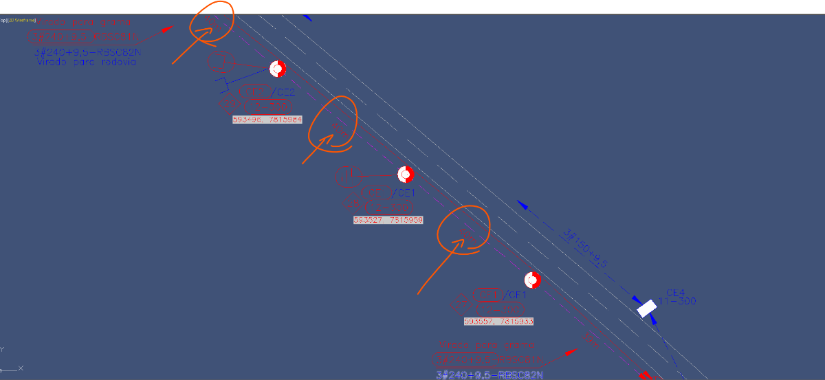

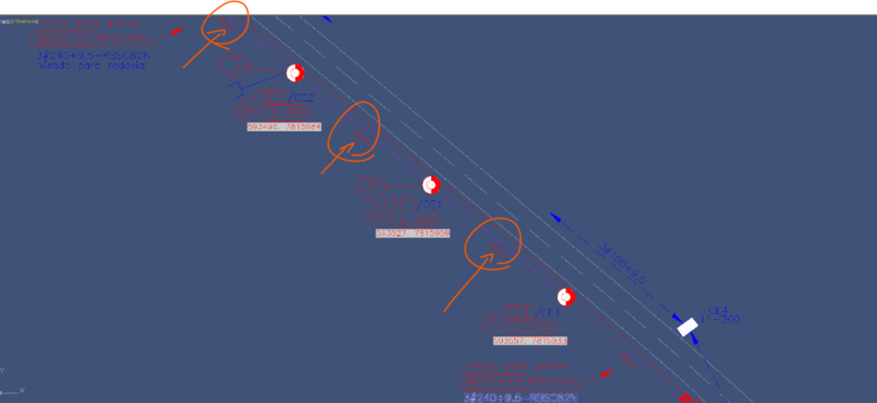

I work with aerial electric projects, and one of most time consuming part of my work is to calc an important variable thats tell the electricians how much  traction put on a cable. To do that im using excel, but I think I can use lisp to catch the cable lenght direct from the drawning and calc that on the fly.
Here is the formula that I need to use:
R=√a³+b³+c³.../a+b+c...
On this formula "a", "b" and "c" are the lenght of cable between the structures, and R is the result.
My idea is to use an lisp to get the lenght info from the text on the drawning, then ask the lisp to use this formula and return the result. Its possible to do this? Or lisps only can make some default math operation?
I`ll put send a print from the drawning to illustrate how it is.
