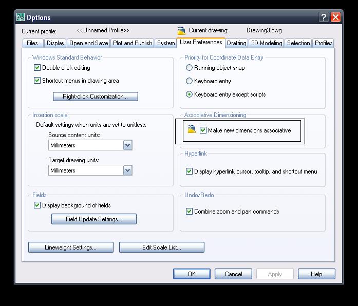

Make sure dim associate is ticked.
>Tools
>Options
>User Pref
>Dim assoc
