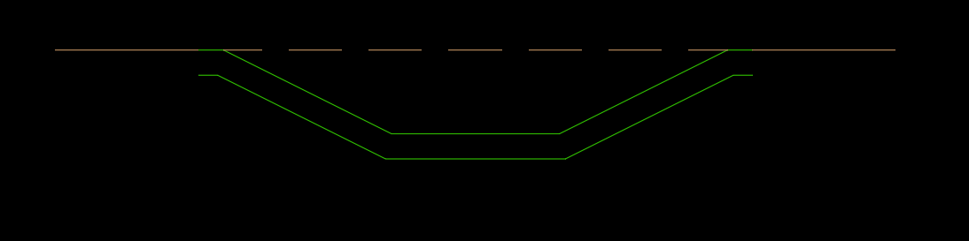

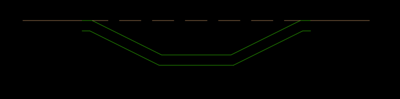

Hi guys i need help to close the 2 green polylines. the goal is to draw a section of a stormwater drain created in my lisp file here is my code that i have so far:

I would make a dynamic block that have measurements you want defined.
I am sure there is a more efficient way to work out the geometry - can think about that another time (I am on my holidays and not doing any thinking about CAD, definitely not thinking about forums and stuff).
The lines are offset so set P2 to be the offset line (use entlast if you want), (assoc 10) this to give the first point and then an (assoc 10 (reverse P2)) to get the last point (will need to check the syntax)
P3_1 corresponds tot he first point, P4_1 to the last point, you shiyklkd be able to make a line at ewach end - name them and use the names, P1m, P2, P3? and P4? to join polyline
Just a thought - or go dynamic block as above
And try this as an example to join the ends together. Many ways to do this.
Also added a check that the layer .concrete exists else make it - you can modify that line to suit what you want but it is useful to have when changing layers just in case (copy and repeat lower down the code?), also moved setting the variable offsetdist and resetting it closer together in case of error it is more likely to be as it was - just me being picky that's all
and since i am on holiday I am not looking at more unless I get bored, though I think there is a better way to work out the points, perhaps using mapcar instead of angles

the lisp does not finish, it doesnt draw anything when i use the code you have given
Missed out a "" , corrected the code above, try again and if it doesn't work let us know
as Bigal - if you want to take this a bit further, his multi getvals has a pop-up dialogue that makes data entry a bit clearer when there are a few values to enter, makes the user interface nicer

The reason why i use offset is because the plines are at angles so if you add a thickness it is hard to work out the correct position of the points, if you have a method of calculating them i am more than happy
