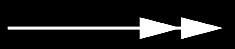

Looking for a lisp where I can select multiple objects and any objects that are overlapping and the same color get grouped together.
I have hundreds of these "arrows" in a dwg that I need individually grouped or block referenced. So they're easier to move and rotate in the future.
Thanks so much for any advise!!

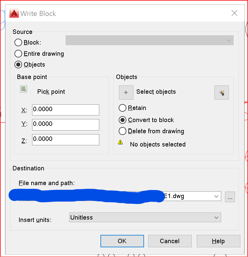

wblock command in AutoCad, as I recall, would be the equivalent.  :beard:
Stands for Write Block I believe.
Lots of available options.

Thats what I was hinting you can get the outline of the arrows as a pline and make it a block with a solid hatch, next step would be to find similar arrows can be done as a select 1 by one pretty easy. Doing an auto all say by layer, would be difficult. O yeah a critical step is to rotate the 1st select objects to the X direction.

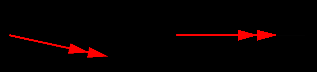

Ok if happy with make a arrow why would you not just make a block and save that for future use, Arrow1, Arrow2 and so on. You can save each arrow to separate dwg or save in a DWT or use say Lee-mac Steal.lsp to pull from another dwg.
Here is how I made an arrow block explained in more detail.
1st step was I rotated the block to a X axis
2nd drew a random pline around the arrow
3rd did BPOLY picking point inside
4th moved Last object to right side
5th turned into a block with solid hatch and set objects to byblock. Change size etc if required. I set the insertion point to the mid pt of the start end.
