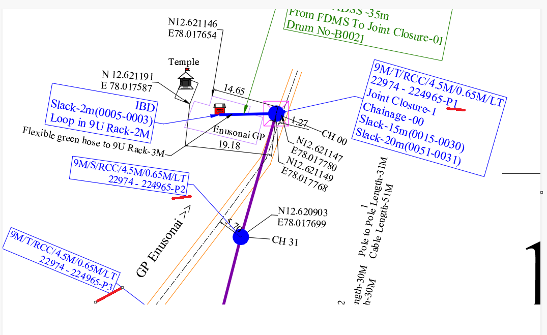

pmadhwal7 Posted December 22, 2022 Share Posted December 22, 2022 Hi all i have some multitext and it contains many type of information with numbering and i was doing manual editing those numbering is their any lsp which gave me those numbering continuously like P1,P2,P3. sample file are attached. Numbring.dwg Quote Link to comment Share on other sites More sharing options...
Steven P Posted December 22, 2022 Share Posted December 22, 2022 If all the texts were the same apart from the Px number at the end this is quite easy, increment text, should be examples out there. However there is a text there with more than just the 9M/T/.....Px this becomes trickier. If you create all the texts, incrementing the last digit as you go, then do the special cases modifications, that is possible. To help us out a bit, what do you want to do, I see the end result but how do you want to get there? Quote Link to comment Share on other sites More sharing options...

pmadhwal7 Posted December 23, 2022 Author Share Posted December 23, 2022 17 hours ago, Steven P said: If all the texts were the same apart from the Px number at the end this is quite easy, increment text, should be examples out there. However there is a text there with more than just the 9M/T/.....Px this becomes trickier. If you create all the texts, incrementing the last digit as you go, then do the special cases modifications, that is possible. To help us out a bit, what do you want to do, I see the end result but how do you want to get there? Please check attached dwg all the text are not same Quote Link to comment Share on other sites More sharing options...

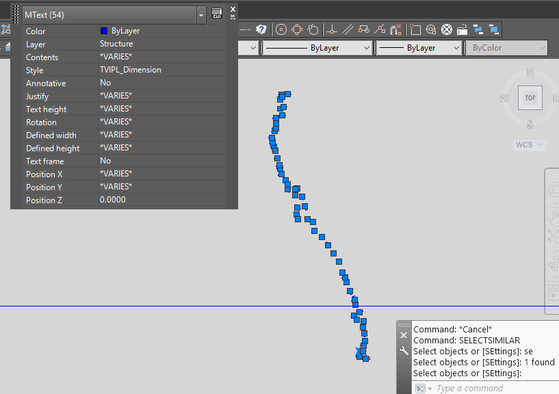

devitg Posted December 23, 2022 Share Posted December 23, 2022 13 hours ago, pmadhwal7 said: Please check attached dwg all the text are not same They are no the same, but all have this root (1 . "*224965-P*") By selectsimilar command there are 54 but with (SETQ PXX-SS (SSGET "x" '((0 . "MTEXT") (8 . "Structure") (1 . "*-P*") ;52 ;(1 . "*224965-P*");; 52 ;(1 . "9M/S/RCC/4.5M/0.65M/LT\\P22974 - 224965-P*");;16 (7 . "TVIPL_Dimension"))) ) So maybe it can be splitted by "-", the last will be ("9M/T/RCC/4.5M/0.65M/LT\\P 22974 " " 224965" "P46") Then get the last and by (setq PXX (last PXX-list)) (setq xx (car( LM:ParseNumbers pxx))) it will return an integer 46 in this case After all this considerations. Please clear us , what do you want to do? Quote Link to comment Share on other sites More sharing options...
BIGAL Posted December 24, 2022 Share Posted December 24, 2022 The simplest way is when make the mtext just add the -Px to it. This is very rough but works. (defun c:addpx ( / x obj str) (setq x 0) ; chnage this to enter value to start -1 (while (setq ent (entsel "Pick mtext ")) (setq obj (vlax-ename->vla-object (car ent))) (setq str (strcat (vla-get-textstring obj) "-P" (rtos (setq x (1+ x)) 2 0))) (vla-put-textstring obj str) ) (princ) ) (c:addpx) As I said already how are you generating the mtext are you typing each entry ? Quote Link to comment Share on other sites More sharing options...
