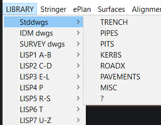

You can do pop menu very easy and display slides that then call correct insert block command. Just make a custom mnu using notepad.

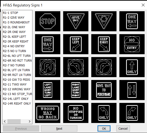

You can also do custom dcl I have 2x2 3x3 4x4 etc they take a list of slide names and display then insert the block.
The last option unfortunately can not get any more is to have TTF fonts of hundreds of traffic signs. They are grouped according to state signs. AS TTF can be used with word etc also. The software came with a menu so displays all the signs by group. They traded as HFS fonts, I have tried to find them again.

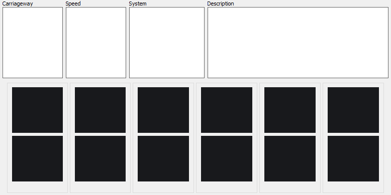

I need to display them in a specific way being the only issue, I don't necessarily need in import/ insert them into cad its more for just display/ info for specifics
I'd like to display each sign and below them specify a distance so it displays an approach for example a set of traffic lights with the correct meter markings, if possible id like to put all the info into one file rather than breaking it down into speed or carriageway type

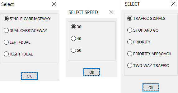

Ok read the better explanation at TheSwamp. Ok 1 way very simple is to use my Multi radio buttons, the difference is you run a sequence of single dcl ending up with the images.
(if (not AH:Butts)(load "Multi radio buttons.lsp")) ; loads the program if not loaded already
(setq ans (ah:butts 1 "V"   '("SELECT SPEED" "TRAFFIC SIGNALS" "STOP AND GO" "PRIORITY" "PRIORITY APPROACH" "TWO WAY TRAFFIC")))
You can do multi radio with 2 or more panels but you must preset can not be dynamic,  if say carriageway and speed is always asked then would use the 2 column version to start. I have seen a 5 column version.
Multi radio buttons.lspMulti radio buttons 2col.lsp

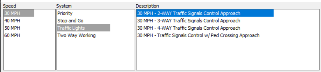

Would it be possible to - from my DATA.ini file when the script is called to make 4 lists which grab all unique data (Carriageway, Speed, System & Desc) so I could use that data to populate dialog lists or radio buttons etc? then match that to the relevant data to the DATA file lists to then able to grab the slide & marker info

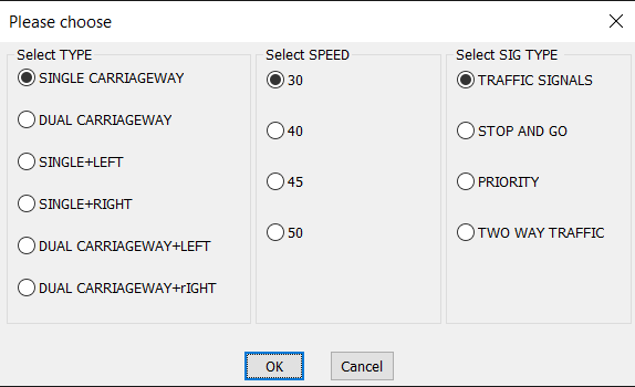

Ok started to put something together ends up with a list that can maybe be found in your big master list.
(if (not ah:buttscol3)(load "Multi Radio buttons 3col.lsp"))
(setq but1 1)
(setq but2 1)
(setq but3 1)
(setq lst1 (list "Select TYPE" "SINGLE CARRIAGEWAY" "DUAL CARRIAGEWAY" "SINGLE+LEFT" "SINGLE+RIGHT" "DUAL CARRIAGEWAY+LEFT" "DUAL CARRIAGEWAY+rIGHT"))
(setq lst2 (list "Select SPEED" "30" "40" "45" "50"))
(setq lst3 (list "Select SIG TYPE " "TRAFFIC SIGNALS" "STOP AND GO" "PRIORITY" "TWO WAY TRAFFIC"))
(ah:buttscol3 but1 but2 but3 "Please choose" lst1 lst2 lst3 "H")
(setq lst '())
(setq lst (cons (list (nth but1 lst1)(nth but2 lst2)(nth but3 lst3)) lst))
 Not sure where to go next
Need say a few combos to understand have the 1st 3 worked out when get to 4th ?

thank you, someone linked me to one of Lee Macs scripts which worked perfect for what m initial aim was
so I've ended up with two files to make this work easier, one which controls the list of items for the dialog, and other which stores the "description" to be able to connect both lists as well as the slide info and marker info
The only issue I'm having ATM is getting it work within a action_tile
