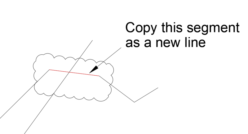

Steven P Posted December 16, 2022 Share Posted December 16, 2022 Happy Friday everyone Before I go off and spend time working this out, does anyone have this that they can share? I have a polyline (1) crossing another (2), the polylines are at different elevations. What I want (to fix another LISP) is to copy the segment of the crossing polyline (1) which crosses the other (2) Sounds like this is the type of thing that someone will have somewhere, thanks in advance Quote Link to comment Share on other sites More sharing options...
mhupp Posted December 16, 2022 Share Posted December 16, 2022 (edited) Don't have anything myself but prob do something like (ssget "_F" cords of poly 1 ((0 . poly))) to find poly 2 fence only uses x and y so will select things on different elevations. find closest point on ply1 to ply2 ??? (only crossing?) or just select poly1 mouse click near location? use point to find vertex # on ply1 (setq v (fix (vlax-curve-getParamAtPoint poly1 (vlax-curve-getClosestPointTo poly1 pt)))) use vertex to find the points on either side (setq StrPt (vlax-Curve-GetPointAtParam poly1 v)) (setq EndPt (vlax-Curve-GetPointAtParam poly1 (1+ v))) entmake (entmake (list '(0 . "LINE") (cons 10 StrPT) (cons 11 EndPt))) --Edit maybe select both polylines use intes on cords with mapcar to find point? --Edit2 https://www.theswamp.org/index.php?PHPSESSID=fa96fb880a6e370b50e4902edc7e1abf&topic=49865.msg550384#msg550384 Edited December 16, 2022 by mhupp 1 Quote Link to comment Share on other sites More sharing options...
mhupp Posted December 16, 2022 Share Posted December 16, 2022 (edited) Here is a manual way using code above. line is created on current layer ;;----------------------------------------------------------------------;; ;; Make a Copy of Poly Segment. (defun C:CopySegment (/ x poly v Strpt Endpt ) (while (setq x (entsel "\nSelect Polyline Segment to Copy: ")) (setq poly (vlax-ename->vla-object (car x))) (setq v (fix (vlax-curve-getParamAtPoint poly (vlax-curve-getClosestPointTo poly (cadr x))))) (setq StrPt (vlax-Curve-GetPointAtParam poly v)) (setq EndPt (vlax-Curve-GetPointAtParam poly (1+ v))) (entmake (list '(0 . "LINE") (cons 10 StrPT) (cons 11 EndPt))) ) (princ) ) --Edit Only works with straight lines. Edited December 16, 2022 by mhupp 2 Quote Link to comment Share on other sites More sharing options...

mhupp Posted December 16, 2022 Share Posted December 16, 2022 (edited) Use Visual lisp command to explode things. It keeps the original and makes copies of the individual entities. So as you step though them to test just delete as you go. Then there isn't a need to undo. This method works with blocks, polylines, hatches, mtext basically anything you can explode into sub entities. (setq poly (vlax-invoke (vlax-ename->vla-object (car (entsel "\nSelect Main Polyline:"))) 'explode)) (setq poly2 (vlax-ename->vla-object (car (entsel "\nSelect 2nd Polyline:"))) (foreach obj poly ;gives a list of all entities created in vla-object name. (setq pt (vlax-invoke obj 'intersectWith poly2 acextendnone)) ;dont know if this works with diff elevation ;or make a list of points (vla-delete obj) ;after test delete entity ) -Edit Over thinking it again. I was like why delete very thing to come back and use entmake!?!? This will work with arc's too. example ;;----------------------------------------------------------------------;; ;; Make a Copy of Poly Segment if intersect (defun C:CPS (/ e p c l) (setq e (vla-get-elevation (setq p (vlax-ename->vla-object (car (entsel "\nSelect Main Polyline: ")))))) (setq c (vla-copy (vlax-ename->vla-object (car (entsel "\nSelect 2nd Polyline: "))))) (vla-put-elevation c e) ;move it to same eleveation as first poly (foreach obj (vlax-invoke p 'explode) (if (vlax-invoke obj 'intersectWith c acextendnone) (vla-put-Color obj 1) ;or change layer, or nothing (progn) (vla-delete obj) ;delete object if intersection not found ) ) (vla-delete c) ;delete copy polyline (princ) ) Edited December 17, 2022 by mhupp 2 Quote Link to comment Share on other sites More sharing options...
Steven P Posted December 17, 2022 Author Share Posted December 17, 2022 Perfect! (mostly - are we ever happy?) Last line (vla-delete check) should be (vla-delete c) , just a typo Am breaking my own rules and looking at CAD on a Saturday, whoops, so on Monday I think I am going alter your code slightly, if I move the vla-get-elevation, vla-put-elevation into the foreach to do that for each segment individually that should cover the case where a polyline elevation changes along it length Something like: (defun C:CPS (/ e p c l) ;; (setq e (vla-get-elevation (setq p (vlax-ename->vla-object (car (entsel "\nSelect Main Polyline: ")))))) (setq p (vlax-ename->vla-object (car (entsel "\nSelect Crossing Polyline: ")))) (setq c (vla-copy (vlax-ename->vla-object (car (entsel "\nSelect Route Polyline: "))))) ;; (vla-put-elevation c e) ;move it to same eleveation as first poly (foreach obj (vlax-invoke p 'explode) (setq e (vla-get-elevation obj)) (vla-put-elevation c e) ;move it to same eleveation as first poly (if (vlax-invoke obj 'intersectWith c acextendnone) (vla-put-Color obj 1) ;or change layer, or nothing (progn) (vla-delete obj) ;delete object if intersection not found ) ) (vla-delete c) ;delete copy polyline (princ) ) Very quickly though gives the error "; error: ActiveX Server returned the error: unknown name: Elevation" - so 90% there will do the rest next week (unless i get bored later today) 1 Quote Link to comment Share on other sites More sharing options...

Steven P Posted December 17, 2022 Author Share Posted December 17, 2022 This will do for a Saturday night for me: Pretty much what you did MHUPP. I set the route elevation to a nominal 0 - it makes things easier later (I should be drawing it at 0 elevation anyway for the other half of the LISP to work), fixes 3d polyline and elevations there In the for each loop I went entmod to each segment / object to move to 0 elevation, check if it crosses the route, and if so put it back to it's elevation else delete as you did. Thanks - will try to break this on Monday now.... (defun C:CPS (/ p c obj pent panda pendb ed) ;; polylines only (setq p (vlax-ename->vla-object (car (entsel "\nSelect Crossing: ")))) (setq c (vla-copy (vlax-ename->vla-object (car (entsel "\nSelect Route: "))))) (vla-put-elevation c 0) ;move route copy to zero elevation (foreach obj (vlax-invoke p 'explode) (setq pent (vlax-vla-object->ename obj)) ; get object entity (setq panda (cdr (assoc 10 (entget pent)))) ; end A (if (= (assoc 11 (entget pent)) nil)() ; end B if applicable (setq pendb (cdr (assoc 11 (entget pent)))) ) (setq ed (entget pent)) (setq ed (subst (cons 10 (mapcar '* '(1 1 0) panda)) (assoc 10 ed) ed )) (if (= nil pendb)() (setq ed (subst (cons 11 (mapcar '* '(1 1 0) pendb)) (assoc 11 ed) ed )) ) (entmod ed) ;move segment to elvation 0 (if (vlax-invoke obj 'intersectWith c acextendnone) (progn (setq ed (entget pent)) ;; can probably delete this line (setq ed (subst (cons 10 panda) (assoc 10 ed) ed )) (if (= nil pendb)() (setq ed (subst (cons 11 pendb) (assoc 11 ed) ed )) ) (entmod ed) ;return segment to elevations (vla-put-Color obj 1) ;or change layer, or nothing (progn) ) ; end progn (vla-delete obj) ;delete object if intersection not found ) ; end if ) ; end for each (vla-delete c) ;delete copy polyline (princ) ) Quote Link to comment Share on other sites More sharing options...

Steven P Posted December 19, 2022 Author Share Posted December 19, 2022 Nice, thanks. Got what I want working for now, though the full LIS doesn't do curves or arcs, this part does - which is something for the future. it is for a 'long section' of a buried service and overall to get the crossing services and surface profile heights where they cross. The lines representing the surface profile should a be lines, those representing other buried services could be lines or polylines, arcs I'll deal with when I find them for now - probably with something like this later. For now the engineers want real work doing tomorrow, Quote Link to comment Share on other sites More sharing options...
