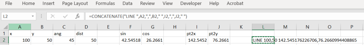

I was able to create something with excel but the only issue now is that each line automatically joins to each other instead of being independent of each other.
We I copy the S column into CAD it does what I need but I can't have them all join together. So close to the fix here.
FORMULA.xlsx
Now that we understand can read from excel direct, the other thing is can skip entries where the curb offset is blank. Thats probably why the copy column S is not working.

A couple of rules its based on what you supplied if you remove or add columns it will not work, the excel must be open, when asked for range can select in this case C2 to J483 or type C2:J483. Then click on AutoCAD screen it may take a moment to appear.
I am not sure if angles are correct please let me know.
