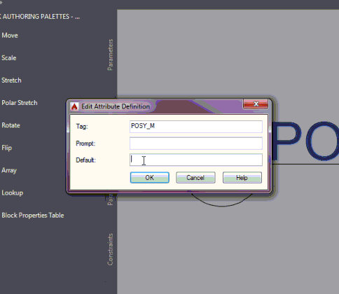

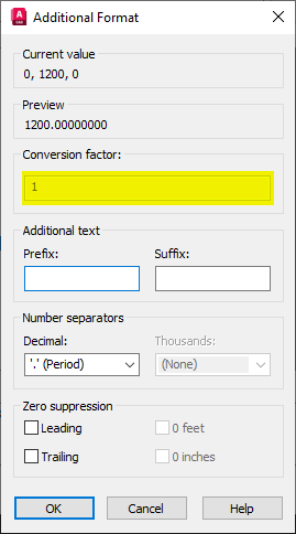

3dwannab Posted December 14, 2022 Share Posted December 14, 2022 See attached the block where we use mm as our units. I would like the Y postion of the block to be in meters. The conversion field is greyed out. Is it possible to do this? Attached a sample drawing also. Y Value to convert to meters.dwg Quote Link to comment Share on other sites More sharing options...
3dwannab Posted December 14, 2022 Author Share Posted December 14, 2022 (edited) Sort of a solution found found below but if I do an attsync name * all the value is lost. https://forums.autodesk.com/t5/autocad-forum/field-conversion-factor-not-working/m-p/5189239#M282561 Edited December 14, 2022 by 3dwannab Quote Link to comment Share on other sites More sharing options...
3dwannab Posted December 14, 2022 Author Share Posted December 14, 2022 (edited) Fixed. I drew a circle inside the block on a no plot layer and used the center prop and the Y and used the formula as per above. See attached. Y Value to convert to meters FIXED.dwg Edited December 14, 2022 by 3dwannab Quote Link to comment Share on other sites More sharing options...
Draughter83 Posted October 12, 2023 Share Posted October 12, 2023 Was there ever an answer to this? I set the conversion factor for one cell in my table and it worked as desired. Now the conversion factor is greyed out for all additional cells. I cannot copy and paste the cells as when I go to update the field to the block whose centre I would like the x and y positions from the cell updates and loses the conversion factor and the co-ordinate is shown to the wrong decimal places. I have also tried creating a new table in a new drawing sheet, run an audit and a restart. I am all out of ideas, but believe this to be a bug of some sort. Quote Link to comment Share on other sites More sharing options...
3dwannab Posted October 12, 2023 Author Share Posted October 12, 2023 @Draughter83this seems an entirely different problem. You might want to create a new thread. Quote Link to comment Share on other sites More sharing options...
