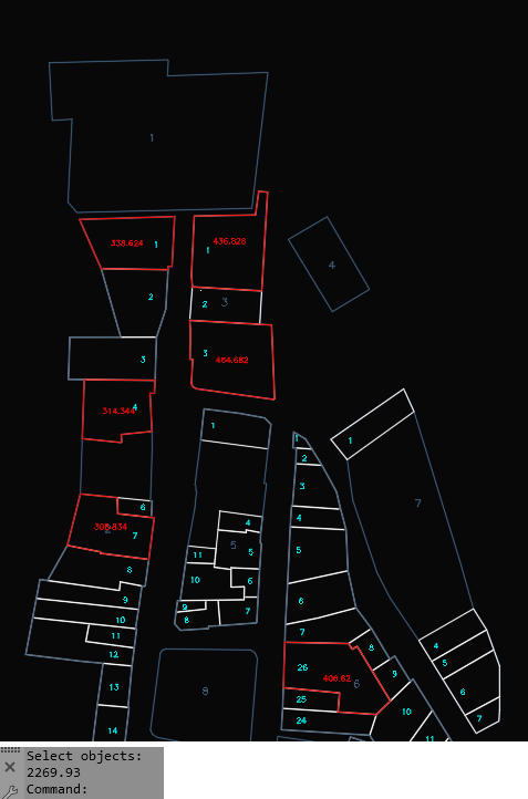

Greetings, a query, I have several polygons and I would like to know which of them are larger than 300m2, for example, that they be marked with a color to identify them, could that be done?

Give this a try:
(defun c:foo (/ c n s)
  (cond	((and (or (setq n (getdist "\nEnter area value to check:<300> ")) (setq n 300))
	      (setq c (acad_truecolordlg 1))
	      (setq s (ssget '((0 . "LWPOLYLINE") (8 . "living"))))
	 (foreach e (vl-remove-if 'listp (mapcar 'cadr (ssnamex s)))
	   (if (>= (vlax-curve-getarea e) n)
	     (entmod (append (entget e) c))
	     (ssdel e s)
	 (sssetfirst nil s)

Thank you very much, but you could have the option to enter the area. Greetings.
Try this change adding new line asking for area value and changing line 4 in full code.
(defun C:PolyArea (/ SS ent poly minarea)
 (setq minarea (getreal "\nEnter area to check for "))
  (if (setq SS (ssget "_X" '((0 . "*POLYLINE") (8 . "LIVING") (410 . "Model"))))
     (foreach ent (vl-remove-if 'listp (mapcar 'cadr (ssnamex SS)))
      (if (>= (vlax-get (vlax-ename->vla-object ent) 'Area) minarea)   ;(>= (vlax-curve-getarea e) 300.) is better

Very interesting, but it could be copied from the LIVING layer by LIVING-AREA with a different color, calculating the area in the center of the polygon or an area chart, for me it would be enough to pass it to another layer and color and then I calculate the areas, I hope it can, thank you very much, greetings.
Give this a try:
(defun c:foo (/ a i ll n s ur)
	      ;; (setq c (acad_truecolordlg 1))
	      (setq i 0)
	   (if (>= (setq a (vlax-curve-getarea e)) n)
	     (progn (entmake (append (entget e) '((8 . "LIVING-AREA") (62 . 1))))

5 hours ago, ronjonp said:
Give this a try:

Thanks, I could know how many polygons were found, I've been trying to add it (prompt (strcat "\n" (rtos i 2 0) "Polylines found")), but I don't know where to place it to give me the result.
