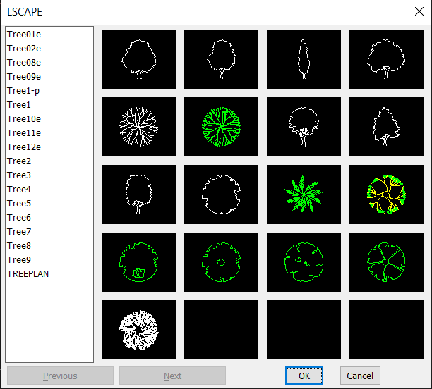

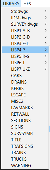

BIGAL Posted December 9, 2022 Share Posted December 9, 2022 If your happy going back to old fashioned pop menu can be done very simply using notepad to make a mnu. You just group your parts under a common name in the menu, the image menu supports next and previous so can have more than 25 images. If you don't want a menu you can make custom dcl's also that load a group of images. 1 Quote Link to comment Share on other sites More sharing options...

BIGAL Posted December 13, 2022 Share Posted December 13, 2022 Forgot you can write your own DCL viewer which like the menu has choices opening next dcl to suit with images. DCL supports child dcl, so would pick landscape then trees open. The data for display would be in a text file just groups of block names, also need a slide image of each block. Quote Link to comment Share on other sites More sharing options...

BIGAL Posted December 15, 2022 Share Posted December 15, 2022 Ok for a pop menu it is easy you just need to make a slide of the block you want, this is used in the menu as the image display. ***MENUGROUP=BIGAL ***POP20 **CADLIB [LIBRARY] [->Stddwgs] [TRENCH]$I=COGGSTDS.TRENCH $I=* [PIPES]$I=COGGSTDS.PIPES $I=* [PITS]$I=COGGSTDS.PITS $I=* ............... rest of menu ***image **PITS [PITS] [SD301,PIT DIM SET OUT]^C^C(openblk "P:/ACADSTDS/CIVIL STANDARDS/CGG301") [SD302,UNHAUNCHED]^C^C(openblk "P:/ACADSTDS/CIVIL STANDARDS/CGG302") .......... add more images Quote Link to comment Share on other sites More sharing options...
BIGAL Posted December 15, 2022 Share Posted December 15, 2022 Part 2 I had to do this for a client recently so the steps for 1 dwg with lots of blocks Get block names and save as a file, edit file and remove unwanted blocks insert block zoom correct size and MSLIDE with block name Write menu code at same time to a mnu file. I ran this like 4 times for different block groups and just cut and pasted the menu together. As the dwg was the master DWT in use this just exposed all the blocks very quickly. The same method though can be done for individual dwgs that are inserted as blocks. Look at trees above. My menu above there are around 200 individual dwg's. I am happy to help, making the slides is like do a 100 in one go. Quote Link to comment Share on other sites More sharing options...
