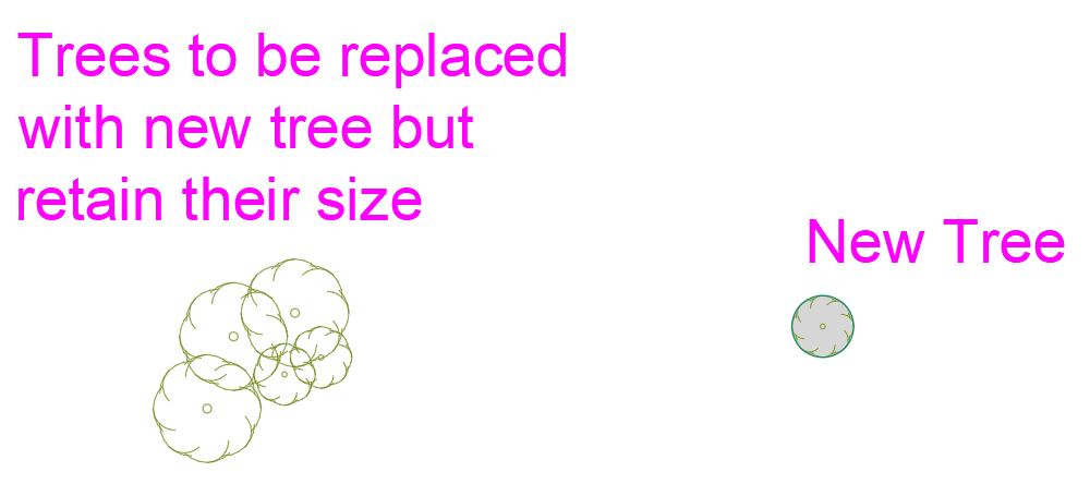

3dwannab Posted December 8, 2022 Share Posted December 8, 2022 I've searched for a routine to do this below but no luck. There's no point in reinventing the wheel, so if anyone know of one that would be great. I see the program working is that it gets the extents of the item and scales the block accordingly. It's probably a very complex program. Attached is a sample drawing. Block Replace but Retain Overall Size.dwg Quote Link to comment Share on other sites More sharing options...
mhupp Posted December 8, 2022 Share Posted December 8, 2022 1. if those old trees are the same block but different scales insert block with scale ; XScaleFactor = 2.0 ; YScaleFactor = 2.0 (vl-cmdf "-Insert" "Blockname" PT 2 2 0) (vl-cmdf "-Insert" "Blockname" PT (vlax-get oldblk 'XScaleFactor) (vlax-get oldblk 'YScaleFactor) 0) 2. if they are the same relative shape, but different sizes use bounding box to get their over all dims divide new block size by old size to get the scale insert block with said scale (vla-GetBoundingBox Newblk 'LL 'UR) (setq LL (vlax-safearray->list LL) UR (vlax-safearray->list UR) L&W (mapcar '- UR LL) ;subtracked UR from LL to get overall lenght and width of block NL (car L&W) NW (cadr L&W) ) (vla-GetBoundingBox Oldblk 'LL 'UR) (setq LL (vlax-safearray->list LL) UR (vlax-safearray->list UR) L&W (mapcar '- UR LL) OL (car L&W) OW (cadr L&W) ) (setq SclX (/ NL OL)) (setq SclY (/ NW OW)) (vl-cmdf "-Insert" "Blockname" PT SclX SclY 0) Quote Link to comment Share on other sites More sharing options...
ronjonp Posted December 8, 2022 Share Posted December 8, 2022 (edited) @3dwannab FWIW .. instead of making a new block for different sizes that have the same geometry create one definition that is 1unit * 1unit and set it to scale uniformly then you can set the size based on the actual canopy area. If it was structured like this, then all you have to do is grab the X value and set that the same on your new block. Just some organizational insight. Block Replace but Retain Overall Size - RJP.dwg Edited December 8, 2022 by ronjonp 1 Quote Link to comment Share on other sites More sharing options...
BIGAL Posted December 9, 2022 Share Posted December 9, 2022 Trees can have 2 objects that are measured, the trunk size and the spread. TR6-3 for us is a 6m dia tree with a 300mm trunk, so next part was use a dynamic block with a circle for trunk and a spread pattern. Looking at point coding correct tree shape is created. So like ronjonp can set the spread of a dynamic block. Next answer if same block but different scales why not bedit and attsync all done. Quote Link to comment Share on other sites More sharing options...
3dwannab Posted December 9, 2022 Author Share Posted December 9, 2022 (edited) The trees have came in from an external survey company and was just trying to hatch the canopy of the tree. So instead of hatching each individual tree I was looking to create one block with the hatched canopy and replace all the other blocks which are inherently different. I do have a tree block that's dynamic which scales to the canopy size, but for this job I just used the existing block. I think @mhupp may have what I was looking. Edited December 9, 2022 by 3dwannab 1 Quote Link to comment Share on other sites More sharing options...
