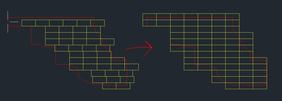

I found this routine which would allow you to select a block with whatever measurements. Then pick a point and fill a closed polyline area. So far it works with the first picture below.
I was wondering how i could make it fill the whole area in a uniform grid to that of the second picture.
Thank you for any guidance on it.

I posted something like this this year or last. cant find it right now but 'll look when i get home.
basically you want to just have a grid of blocks that cover the whole polyline.
Then use ssget with "CP" and polycords to select any block that is crossing. and delete the rest.
That sound about right, the only other thing i could think of, is to always keep the orientation left and right and create an angle from that. Again thank you!
Did this for something else, pick say pline, then get boundingbox overfill the pline with the grid boxes using array, then do a ssget wp this gets all grids that touch and within put on dummy layer and turn off, erase grids that are on, turn back on dummy layer and change layer of grids. You need a grid starting point at say a true co-ord ie in grid spacing 10x20 do this by rounding down the lower left corner to a grid space value. This is how I remember doing this like 20 years ago not tested.

I stumbled upon superhatch, which seems to give me exactly what I needed. Just wanted to let you know. Again, thanks for the help.

little edit so it selects all the blocks inside and crossing polyline
