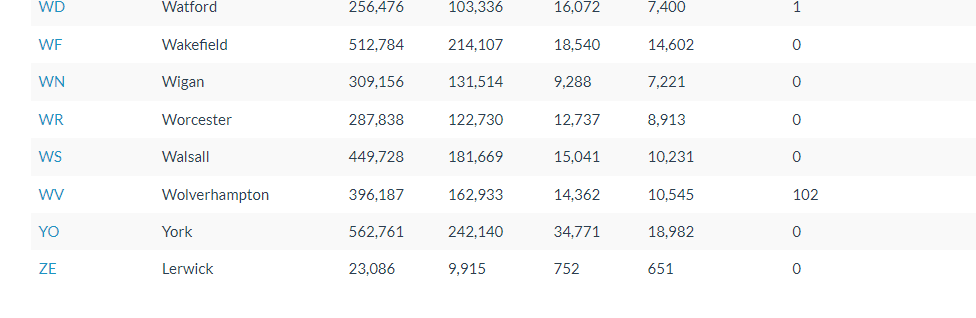

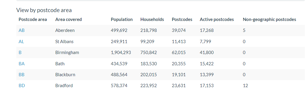

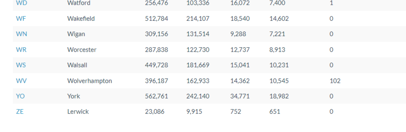

Charpzy Posted December 7, 2022 Author Share Posted December 7, 2022 Where abouts did you download this from? this file would be much more useful than the ones i currently have 34 minutes ago, devitg said: I downloaded the AL postcode , of course is huge . I strip the header and 2 first PC. It have all data , 53 columns, and 7779 rows + head PostcodeIn Use?LatitudeLongitudeEastingNorthingGrid RefCounty AL1 1AGYes51.74529-0.328628515487206498TL154064Hertfordshire AL1 1AJYes51.744498-0.328599515491206410TL154064Hertfordshire AL postcodes - header and first 2 .csv 2.47 kB · 0 downloads AL postcodes.csv 5.93 MB · 1 download Quote Link to comment Share on other sites More sharing options...
eldon Posted December 7, 2022 Share Posted December 7, 2022 When Latitude and Longitude are mentioned with the Ordnance Survey, I always wonder whether it is referenced to the Prime Meridian, the "Golden Nail" at Greenwich, or to the GPS Meridian which is 103m further east? Quote Link to comment Share on other sites More sharing options...
devitg Posted December 7, 2022 Share Posted December 7, 2022 3 hours ago, Charpzy said: Where abouts did you download this from? this file would be much more useful than the ones i currently have I did from England POSTCODE up to Quote Link to comment Share on other sites More sharing options...
