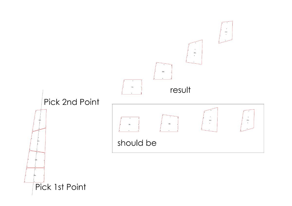

Juergen Posted June 1, 2023 Author Share Posted June 1, 2023 Hi, I use the code from AlanH. Please see my image. Is it possible to bring the objects in one line? Thanks for help. ; very simple copy plines and whats inside to right ; By AlanH March 2023 (defun c:wow2 ( / pt1 pt2 ss ss2 x dist oldsnap) (setq pt1 (getpoint "\Pick 1st point ") pt2 (getpoint pt1 "\nPick point 2 ")) (setq oldsnap (getvar 'osmode)) (setvar 'osmode 0) (setq x 0) (initget 7) (setq dist (getdist pt1 "\nDistance for copy?: ")) (setq ss (ssget "_F" (list pt1 pt2) '((0 . "LWPOLYLINE")))) (if (= ss nil) (alert "No objects found") (repeat (sslength ss) (setq plent (ssname ss x)) (setq co-ord (mapcar 'cdr (vl-remove-if-not '(lambda (x) (= (car x) 10)) (entget plent)))) (setq co-ord (cons (last co-ord) co-ord)) ; make a closed list (setq ss2 (ssget "_wP" co-ord)) (setq ss2 (ssadd plent ss2)) (command "_.move" ss2 "" "0,-20000" (list dist 0.0)) (setq x (1+ x) dist (+ 2000 dist)) ) ) (setvar 'osmode oldsnap) (princ) ) (c:wow2) Quote Link to comment Share on other sites More sharing options...
