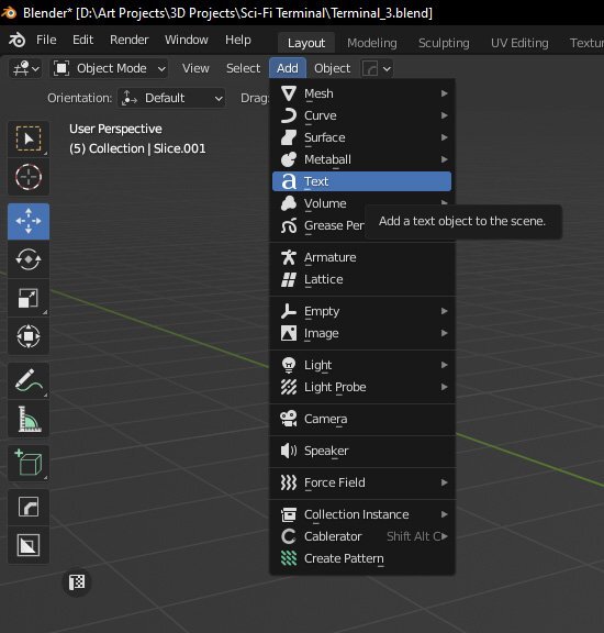

As for your question, the answer is, you're using the wrong program. Like I've mentioned before, Blender is not a CAD program. It's a 3D modeling, rendering, animation program.
Text is easy enough to create. Just go to the "Add" menu and click "Text", as shown in the image below. But there is no such thing as leaders in Blender. You might be able to create something that looks like a leader, but it will not be easy and it will be difficult to edit or manipulate it, so I'm not going to spend time trying figure it out. If you want to be able to add text and leaders and other notation, you should be using a CAD based program.

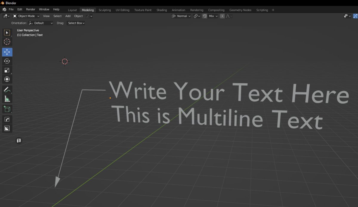

Ok, since I'm a glutton for punishment, I decided to see what it would take to create a leader. It took about a minute or so to create the one in the image below, but you would have to manually create one for every piece of text in your file, and trying to maintain line thickness and arrowhead size across all leaders would be extremely difficult. So my verdict is that it's not worth the effort.

There's no way I'll be able to explain how I did it. Not that it's all that difficult, but it does require some knowledge and understanding of how the modeling tools work. Scaling, extruding, manipulating and merging vertices and the ability to adjust everything to make the leader line and arrowhead look proportionally correct. If Dave wants to try it, the order of operations are listed below. I even provided a link that explains how to merge vertices.
Create a plane
Scale it and move vertices so it's a short thin horizontal landing
Extrude edge down to create the leader line
Extrude edge down to create the length of the arrowhead
Extrude edges out on each side to create the width of the arrowhead
Merge vertices to create the point of the arrowhead
Move and adjust vertices to get the leader line thickness consistent and the arrowhead proportionally correct.
This whole thing is an exercise in futility though, since Autocad can create leaders automatically.
