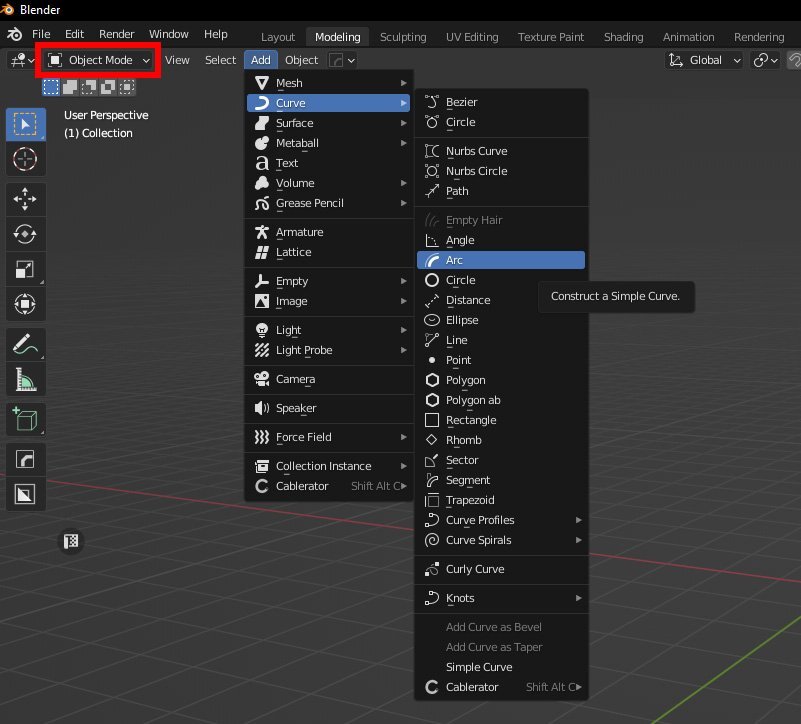

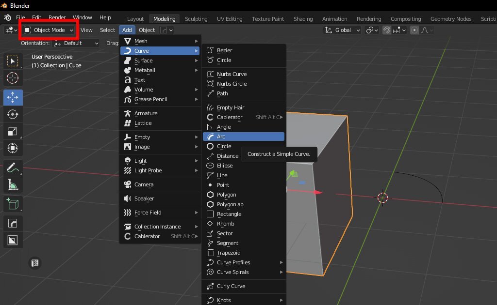

Cad64 Posted December 2, 2022 Posted December 2, 2022 Here's one way to create an Arc. In "Object" mode, Go to the "Add" menu Select "Curve" Select "Arc" Quote

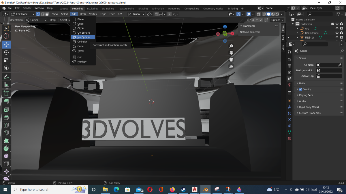

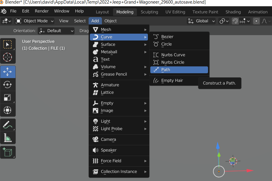

davenutron Posted December 2, 2022 Author Posted December 2, 2022 thanks for that, unfortunatly I find a problem I am stumped maybe im in the wrong mode please check what this list shows me Quote

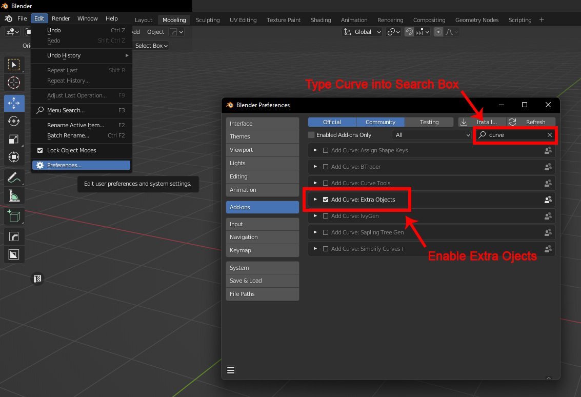

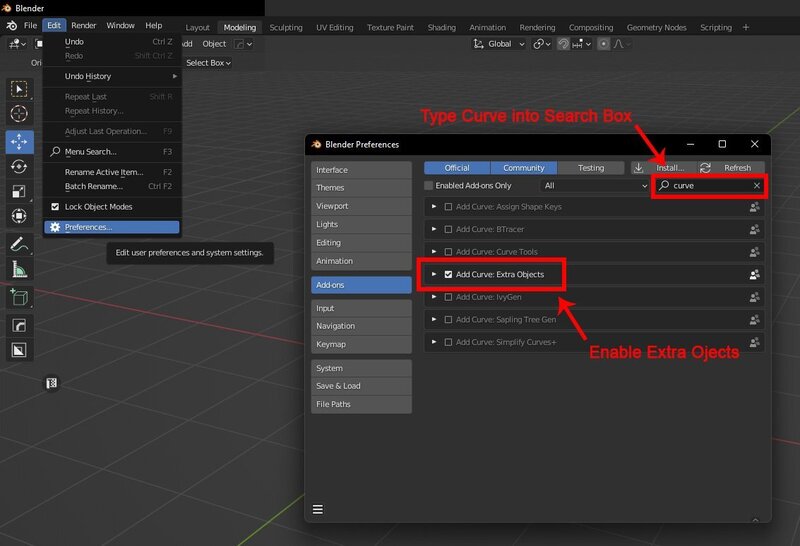

Cad64 Posted December 2, 2022 Posted December 2, 2022 Sorry, I forgot to mention that you need to enable the "Extra Objects" in Preferences. Some functionality is not enabled by default when you install Blender. Go to the "Edit" menu and click "Preferences" In the Preferences window, go to the "Add-ons" section Type "Curve" into the Search Box Enable the "Add Curve: Extra Objects" option Quote
davenutron Posted December 2, 2022 Author Posted December 2, 2022 thats amazing you can help me with this thank you, I now selected curve unfortunatly nothing happens when I left click to use it, any idea what im doing wrong Quote
Cad64 Posted December 2, 2022 Posted December 2, 2022 When you go to "Add" "Curve" "Arc" it should drop a curve object into your scene somewhere around the X, Y, Z origin. If you have other objects in the scene, it might be underneath something, so you will need to look around. Quote

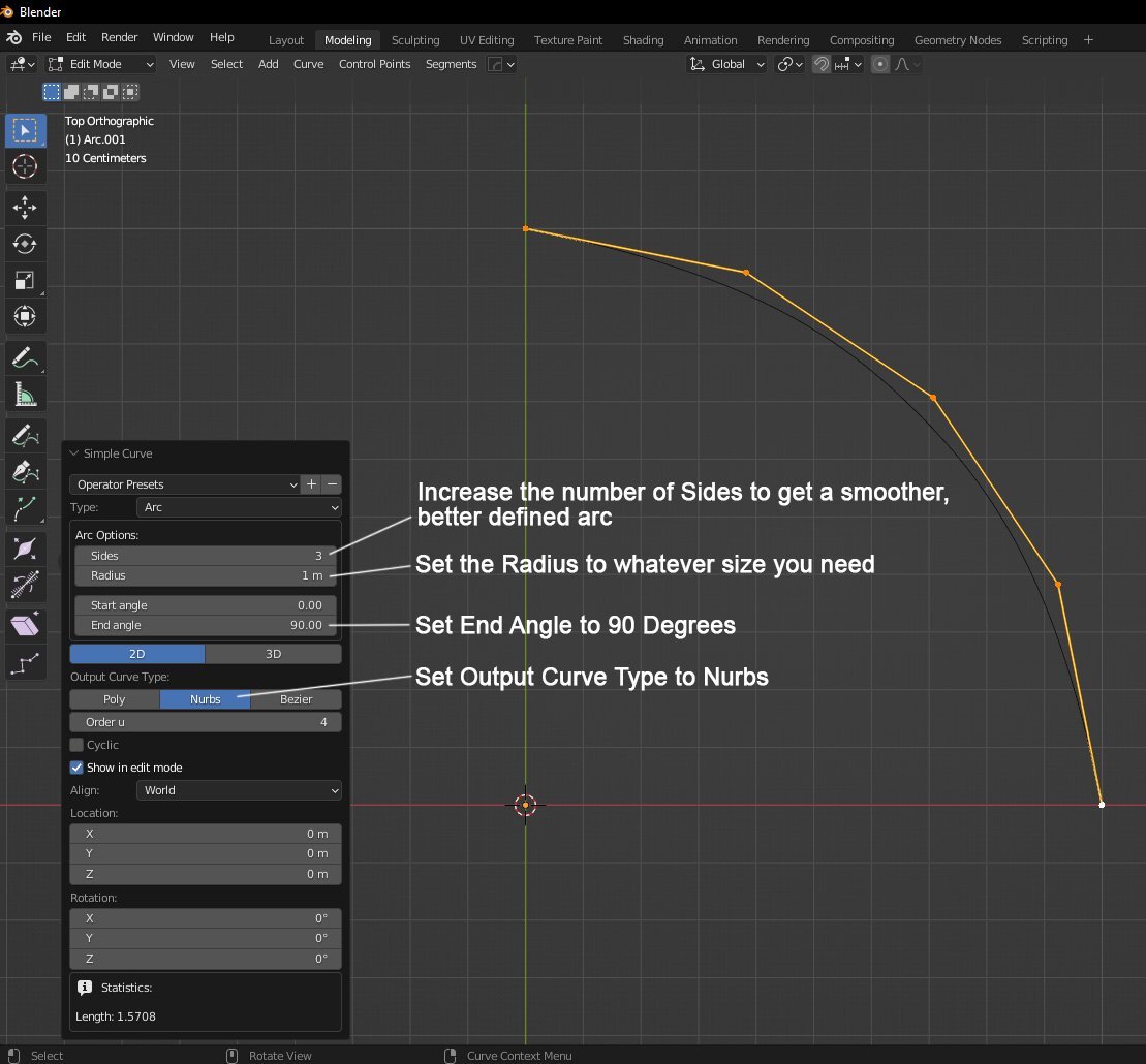

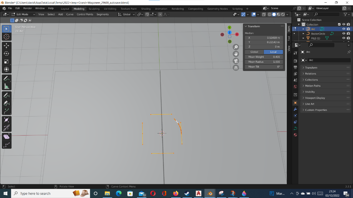

davenutron Posted December 2, 2022 Author Posted December 2, 2022 (edited) I found what the arc is, but its verticies I need a solid line also the verticies are not a complete arc shape as in the stop before they make a quarter circle, also I tried circle and it produced a square shaped verticies. Please take a look at what I mean Edited December 2, 2022 by davenutron Quote
Cad64 Posted December 2, 2022 Posted December 2, 2022 Well, Blender is a polygon modeling program, not a CAD program, so you're not going to get the same type of arc that you would get in Autocad. But, you do have some options. After you create the arc, look down at the bottom left corner of your screen and you will see a little closed menu named "Simple Curve". Click on it and it will expand and you will see all the options you have available. You will see that the "Output Curve Type" is set to Bezier by default. Change that to Nurbs. Also, you will see that the "End Angle" is set to 45 degrees. Change that to 90 degrees in order to get a full quarter arc. Quote

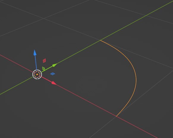

Cad64 Posted December 2, 2022 Posted December 2, 2022 No, I have no idea why this is happening. It sounds like your movement is restricted to the X,Y plane for some reason, but I don't know why. You're in Object mode, with your arc selected and your Move Transform gizmo looks like mine below, right? With the red, green and blue arrows? Quote

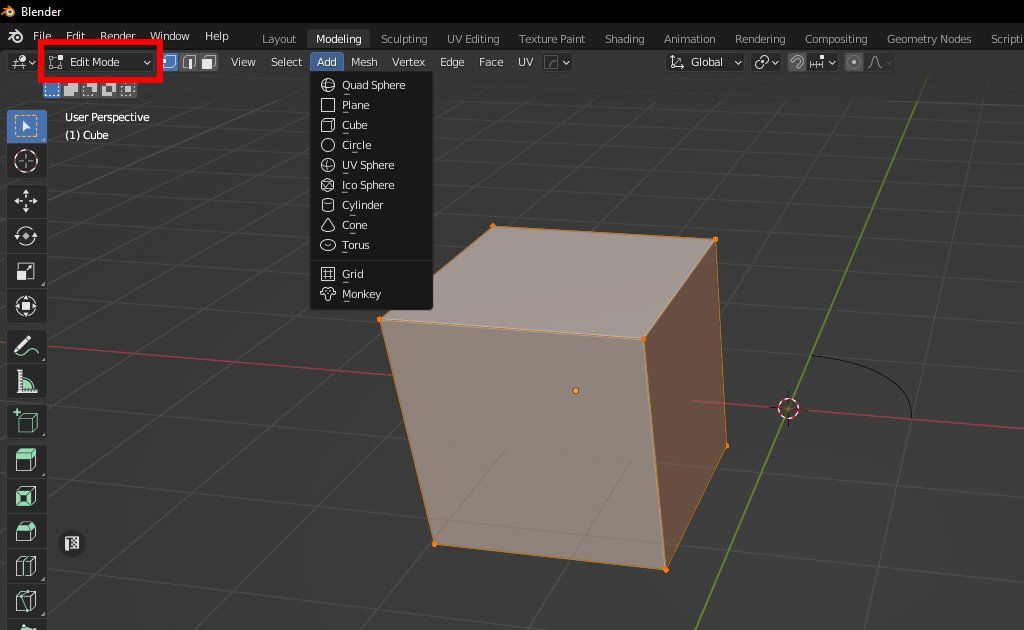

davenutron Posted December 3, 2022 Author Posted December 3, 2022 I did have the move arrows earier today but it might have been the arrows from the world that I was selecting. I cannot select the arc now in edit mode or object mode also arcs cannot be produced anymore even though I have ''Add Curve: Extra Objects'' selected. Quote
ReMark Posted December 3, 2022 Posted December 3, 2022 On 12/2/2022 at 6:43 PM, davenutron said: sorry about the wrong forum I have noted it. I am trying to display a door swing so its quite simple thanks for your help Who puts door swings in 3D drawings? Quote
Cad64 Posted December 3, 2022 Posted December 3, 2022 On 12/3/2022 at 10:20 AM, davenutron said: I cannot select the arc now in edit mode or object mode also arcs cannot be produced anymore even though I have ''Add Curve: Extra Objects'' selected. That's because you have an object selected and you're in Edit mode. You can't create an arc, or select other objects when you're editing a current object. Switch to Object mode and then you will be able to select another object or create an arc. In the first image below, you can see that I have a cube selected and I'm in Edit mode, so I can't create an arc In the second image, I have switched to Object mode and I can now create an arc. Quote

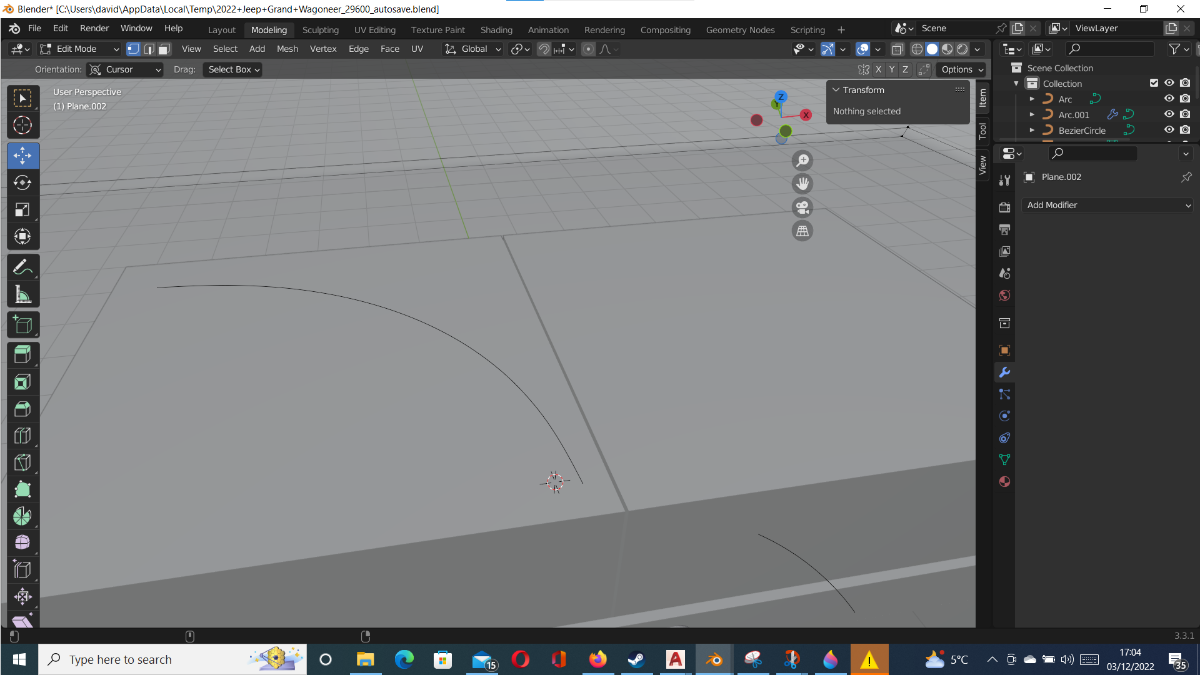

davenutron Posted December 3, 2022 Author Posted December 3, 2022 I have it all working now no idea what was going on I have mirrored my arc and I want to delete 1 of the arcs but both are being deleted when I only select 1 arc. see picture. So the question is how to seperate arcs Quote

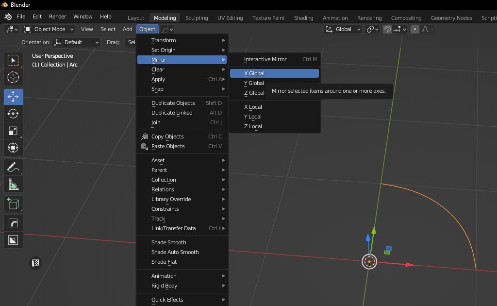

Cad64 Posted December 3, 2022 Posted December 3, 2022 How did you mirror the object? In the image below, If you go to "Object" "Mirror" and then select either "Global" or "Local", that will mirror your object and delete the original. If you used a Mirror Modifier, You will have to convert the arc to a mesh, in order to remove the modifier. Then you will have to go into Edit Mode and window select the half of the arc you don't want and delete it. But this is going to leave you with an arc that has about 100 vertices which is not good. I would recommend that you Undo the mirror operation and then use the method in the image below. Quote
