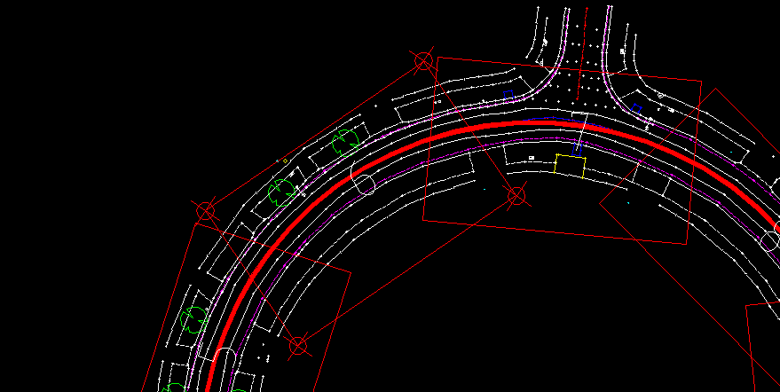

Maybe a simpler way you get the 4 points of the viewport then use a trans to convert the 4 points to mspace points you can then use a ssget "WP" pts. Remember to add the 1st point as last point so box closes. ie 5 points.
You want the opposite of this, this takes a point in mspace with a twist viewport etc and converts it to a Pspace point.
(setq psnewcen (trans (trans newcen 1 2) 2 3))
Sorry dont have the right way at my finger tips.
Trying to remember if chspace works for pspace point converted to mspace I think it does. Tried this picked 4 corners of viewport and made a POINT.
You can see the points in model, the red rectangles are the viewport windows seperate code.
Edited by BIGAL
  • Agree 1
