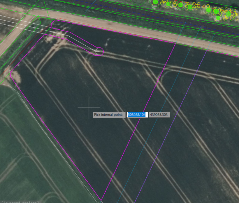

Hello I need some help please. I have put together this code here. the working principles of this is to do the following
Select all objects layer
Offset distance =
Offset distance =
Offsets are done in and out of every layer that is selected at the required offset distance.
Boundary command is done to work out the internal boundary of area selected
Continue onto the next boundary to select
when exiting the command the offsets that were produced are deleted the only thing to remain is the boundary lines
But there is a bit of a problem with this command as shown below
as you can see the boundary that was created in pink did not consider the white polyline in this boundary. So I thought then the polylines that are offset should be a closed shape but I dont know how to do that in lisp so if anyone knows how to do this that would be great.
I found this
https://cadtips.cadalyst.com/linear-objects/draw-a-cap-or-pipe-end?q=linear-objects/draw-a-cap-or-pi...
which I used and it is really good but it needs to close these objects automatically without me selecting anything.
I appreciate any help that can be given I appreciate it might not be possible.

This might need a little reworking on the offset part to create a closed polyline object - which should be OK after that?
It should be possible, I think in one of your previous questions I offered a (longer and slower) solution that had a while loop - might be that this can be modified to create a closed polyline from an offset line or whatever using the end points of the new offsets, then join them together.
I'll have a think later to see if I can make something up that works there
Yes that might work thank you for replying and being so active on this!! I have another solution that might be a possible solution as well.
It involves adding a small circle to the end of every polyline/line (0.01m or so). Then when the offset is done it is joined. that circle can then be deleted with the rest of the offsets at the end.

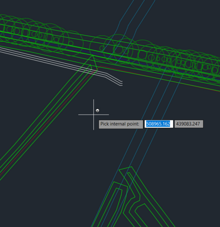

Hi @Steven P Thank you for getting on this. I tried it out and it worked very well at closing the lines and doing the offsets. There was one problem that I was finding that it wasn't moving onto the boundary command afterwards. Thank you very much for your help It is very useful to see how this code is written learning a lot.
Expand
Can you post a sample drawing of what you tried - it worked for me just now
