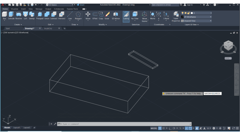

davenutron Posted November 24, 2022 Posted November 24, 2022 I can just about create a box in autocad How do I adjust or start from scratch to make its size? Quote

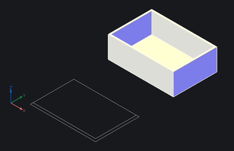

ReMark Posted November 24, 2022 Posted November 24, 2022 (edited) Are you creating a 3D box? The one shown below is 36x24x12 high with a thickness of 0.75 inches. Edited November 24, 2022 by ReMark Quote
davenutron Posted November 24, 2022 Author Posted November 24, 2022 Hi please write all steps and things to notice when making a box, also I need to select metric how should I do that? I am on acadiso file. Quote

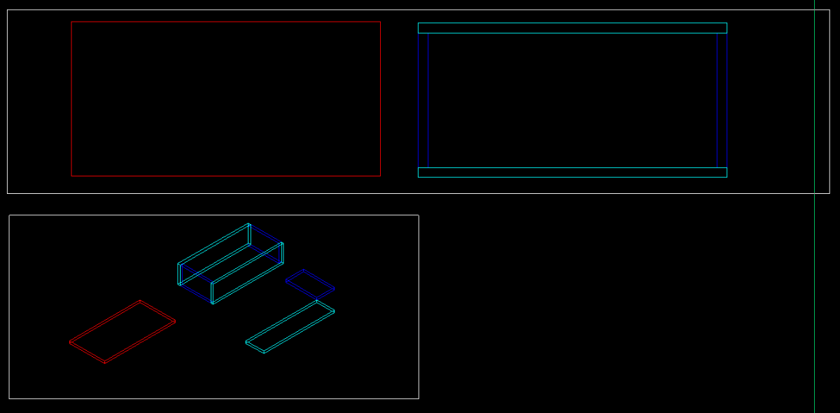

ReMark Posted November 24, 2022 Posted November 24, 2022 (edited) If you are using the acadiso.dwt (drawing template) then it is already set up to utilize metric. Here is one way to create a box. Create a rectangle using the Rectangle command. Offset the rectangle the required thickness of the box you want to create. Reorient the UCS so that the Y axis is pointed up. Move the inner rectangle the required thickness. Reorient the UCS so the Z axis is up. Extrude the inner rectangle to a height slightly higher than what your finished box will be. Extrude the outer rectangle to the exact finished height. Subtract the inner rectangle from the outer rectangle. Done. By the way, how's that 3D toothbrush coming along? Have you made any progress at all or did you give up? Edited November 24, 2022 by ReMark 1 Quote

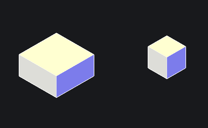

ReMark Posted November 25, 2022 Posted November 25, 2022 (edited) Maybe you should have been more specific with your question. I can only assume that you are referring to the BOX command in AutoCAD. Is that correct? If that is the case then invoke the BOX command and type "L" for the Length option. Now look at the command line prompts. You will be asked for the length, the width and the height. At each prompt you merely type in the desired measurements. Your output will look like this. It couldn't be any easier. When you mentioned you wanted to create a box, I had in mind an object that one might put something in not a cube. A box is a space; a cube is a three dimensional solid figure formed with squares. BTW... did you know you can look in the AutoCAD HELP file and get instructions on how to use each command? Try it sometime. Edited November 25, 2022 by ReMark Quote
BIGAL Posted November 25, 2022 Posted November 25, 2022 Like ReMark we can not really spend lots of time teaching you, like the TV show "Phone a friend" Anyway big hints Do Box twice use Subtract All done. Quote
ReMark Posted November 26, 2022 Posted November 26, 2022 Actually, BIGAL the OP really wanted to know how to use the BOX command (under Primitives) to create a 6-sided cube with specific dimensions. Yet, the OP goes on to say... "I am looking to do is make a box with the tool on autocad not a 6 sided box but I need to use diamentions." Go figure. Quote

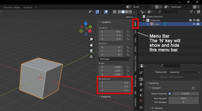

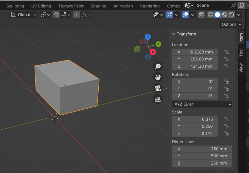

davenutron Posted November 28, 2022 Author Posted November 28, 2022 any idea how to put the length width and depth in as desscribed eariler but in blender there is no command line On 25/11/2022 at 12:06, ReMark said: BOX command in AutoCAD. Is that correct? If that is the case then invoke the BOX command and type "L" for the Length option. Now look at the command line prompts. You will be asked for the length, the width and the height. At each prompt you merely type in the desired measurements. Quote

ReMark Posted November 28, 2022 Posted November 28, 2022 (edited) 1 hour ago, davenutron said: any idea how to put the length width and depth in as desscribed eariler but in blender there is no command line You could not grasp the concept of creating a cube, via dimensions, using AutoCAD but you somehow think you'll be able to do it using Blender? Add Cube - Blender Manual: https://docs.blender.org/manual/en/latest/editors/3dview/toolbar/add_cube.html#:~:text=The tool works by first, below to constrain the object. Edited November 28, 2022 by ReMark Quote
Cad64 Posted November 28, 2022 Posted November 28, 2022 2 hours ago, davenutron said: Will anyone offer their services to give me a blender tutorial 20 pounds an hour on teamspeak or discord or irc. I could use a couple of hours I only need to creat blocks nothing difficult I already gave you links to (3) really good Blender Youtube channels in your other thread. These channels have literally hundreds of hours of free tutorials. Anyway, you don't need a couple hours to learn how to create basic blocks. Here's a 6 minute tutorial: Quote
