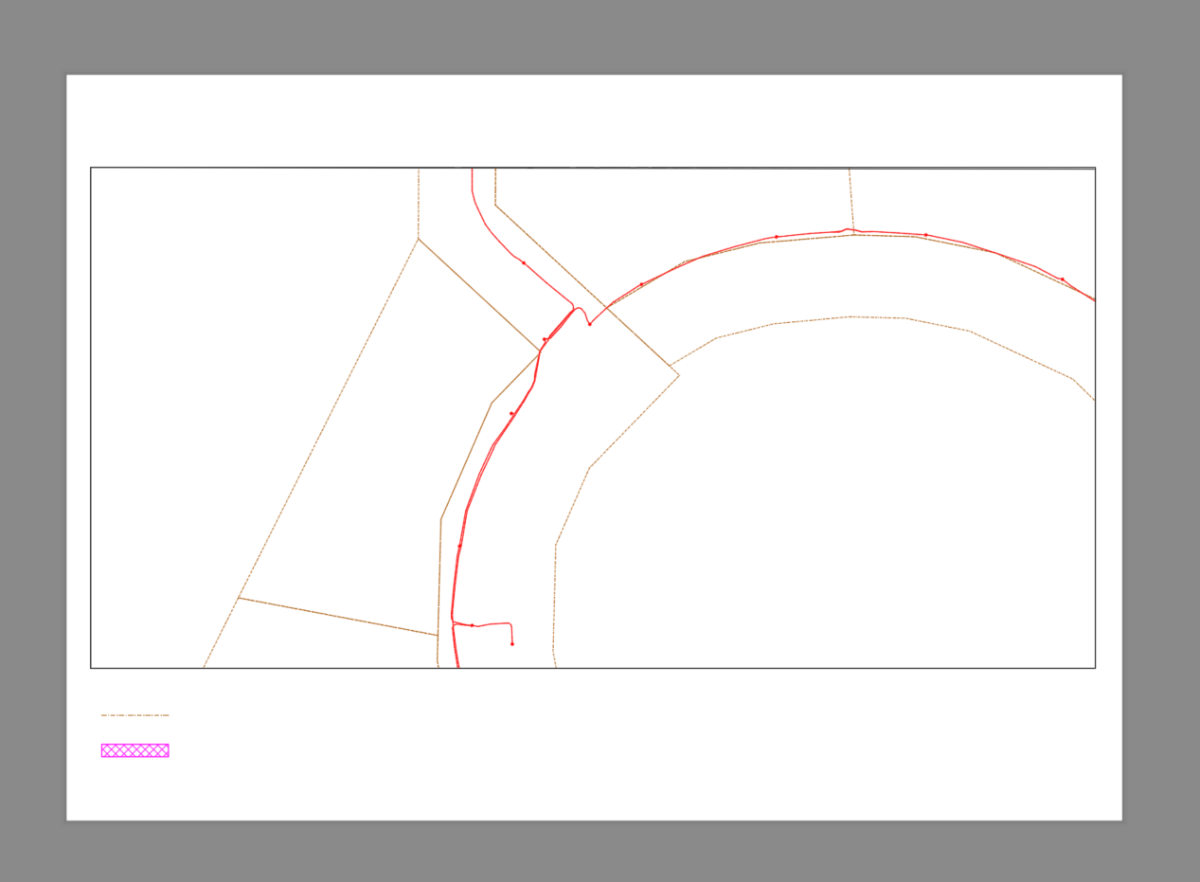

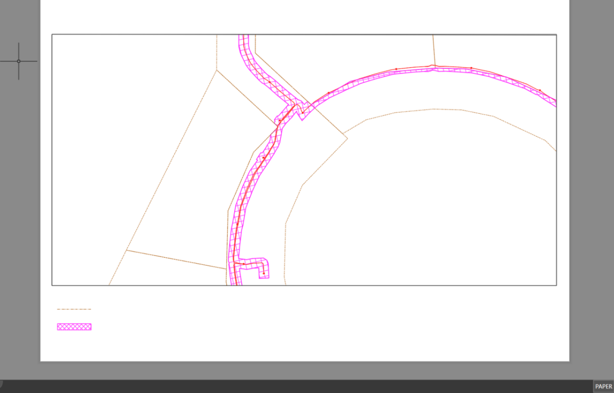

In the first picture I'm on layout paperspace and there I can see everything I draw, but once I plot it (or preview like on 2nd picture) - it's gone.
I already tried HPMAXLINES and FILLMODE. And this has happened on 3 different files with similar, but not exactly the same hatches.
3 hours ago, BIGAL said:
Is the hatch on a no plot layer, post dwg so can look at it.
Thank you, it was indeed on a no plot layer.
It has never happened before and I couldn't find solutions on different forums when people posted about similar problems.
Do you know if there's a reason why basically all layers (where I drafted) were suddenly no-plot?
If you select layers in the layer manager and hit no-plot icon that will set them to just that. Maybe accidental click.
