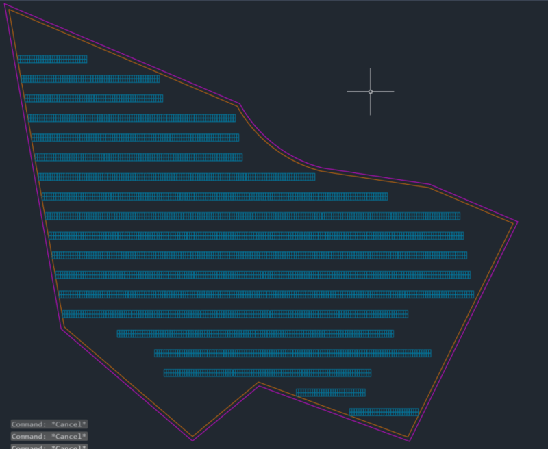

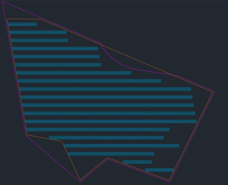

Updating two parallel at the same time when one is amended
Sorry for flaking IRL stuff has come up. upload your test drawing.
This should do it
  • select two polylines obj1 obj2
  • offset obj1 in 2 feet
  • checks if offset only created 1 polyline
  • gets the geocenter of offset polyline p1
  • uses boundary command with new point to create a boundary (offset + boundary = area you want)
  • gets bulg information from boundary poly p2
  • deletes 2 ft offset poly p1
  • updates polyline obj2 with boundary cords of poly p2
  • deletes boundary polyline p2
  • updates bulg info to obj2
-Edit
You might have to isolate the two layers for the boundary to work correctly tho it is set to ignore islands.
Also since im using BricsCAD  the boundary command might be diffrent in AutoCAD.
(command "_.Boundary" "_A" "_I" "_N" "" "_non" cen "")
use "-boundary" to Enter the choices at the command prompt
-Edit
layiso update
UFP-iso.lsp
Edited by mhupp
  • Thanks 1
That works brilliantly thank you very much. I removed the "_non" from the boundary command and then it worked perfectly.
      (command "_.boundary" "_a" "_i" "_n" "" "" cen "")
Thank you so much you are a hero
