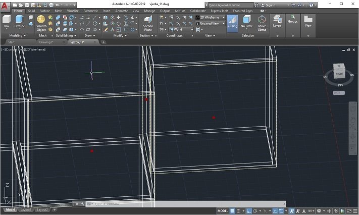

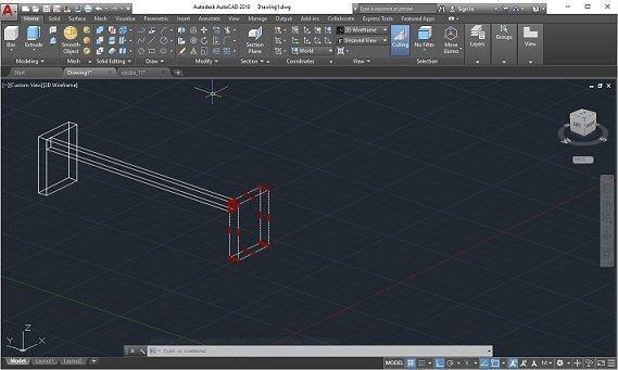

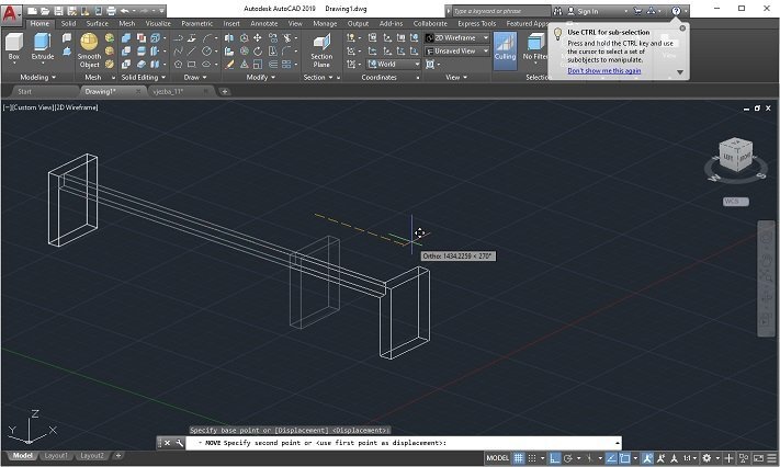

Mladen Posted November 20, 2022 Share Posted November 20, 2022 Hi, I am a kind of a newbie. Worked in Autocad many years ago so please adjust your replies to have a details of how to. I am drawing a kitchen cabinets for DIY in 3D. While drawing was simple I have managed to easily modify cabinets – CTRL + PICK WINDOW FROM LEFT TO RIGHT -> to have a RED GRIPS no the blue onea, and then MOVE commad to stretch cabinets. Q1.: What is the alternative way – STRETCH command doesn´t seem to work, it only moves elements of the cabinets. 1st and 2nd picture Now, the drawing is a little bit more complex and with CTRL + PICK WINDOW I am not able to do afforementioned – it gives me solid faces center dots (Q2.: can I turn off that option (CTRL + W doesn´t seem to work). Even if all of the other elements in the nerby are isolated trought right click/islolate/hide the problem persist. Any ideas? 3rd picture One more thing. On some box element, when selected I have only one dot/blue grip. Q3.: Why there are no blue arrows and rectangles for stretching? 4th picture I do most of a drawing with BOX command, Autocad 2019. Sorry for simple and maybe foolish problems that I have, gratefull for support Quote Link to comment Share on other sites More sharing options...

Mladen Posted November 20, 2022 Author Share Posted November 20, 2022 For Q1 and Q2 here is an example of what I am trying to do without plug-in mentioned in the video, but as said, I have managed to do so only when the drawing is simple without other cabinets (and faces) nearby. If there are other faces, then CTRL + WINDOW don´t allow red grips only red dots as mentioned Quote Link to comment Share on other sites More sharing options...
