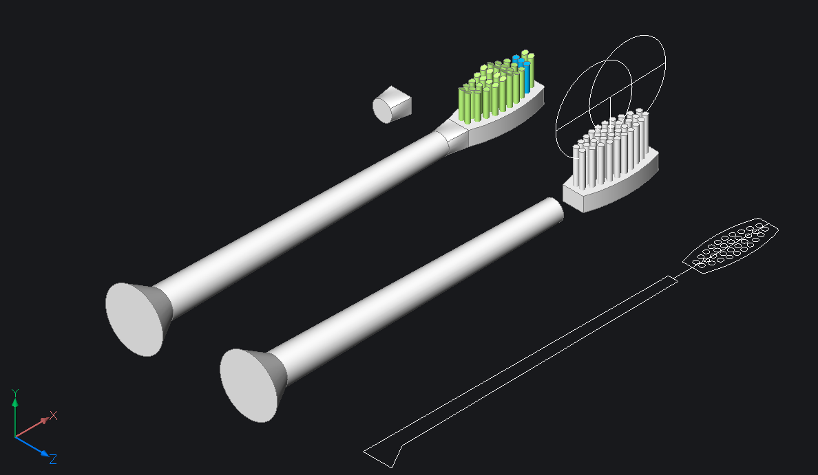

ReMark Posted November 24, 2022 Posted November 24, 2022 (edited) The following is offered in the spirit of the season. While not fully a step-by-step guide it does provide the commands used to create the handle, head and transition piece (between the handle and head). Since I did not have an actual electric toothbrush head to take measurements off of, I used by imagination. It is what it is. You must be familiar with changing the orientation of the UCS at any given step in the process. You must also be familiar with Osnaps (ex. - ENDpoint, MIDpoint, Quadrant, etc.) as they aid in drawing accuracy. Note: this is just one way of accomplishing the task. AutoCAD gives us many options. 2D Handle: Polyline, Orthomode and Osnaps enabled. 2D Head: Line, Arc, Circle, Fillet and Pedit. 3D Handle: Revolve. 3D Head (includes base & bristles): Extrude (PushPull would suffice as well). 3D Bristles (curvature): Line, Circle, PushPull, Subtract 3D Transition (between handle & head): Circle, Rectangle and Loft. Color of bristles handled by Layer although you could elect to draw everything on layer 0 then override the color of the bristles. Your choice. Visual style: Conceptual. And this, as they say, was the result... Edited November 24, 2022 by ReMark Quote
